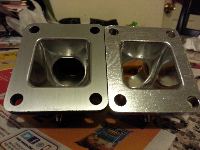

hi forum. I set up the pump, and block plate. started the 6psi test.
ped
Posts: 1598
Location: northeast usa
Re: First spree AF16 motor swap. more photos of motor work.
Post by ped »
hi forum. I found a leak. the brand new CT manifold gaskets are leaking. :surprise: . I will have to make new ones. :bs:
If anyone is using the gasket that came with your CT manifold. I would check them.

flat all the surfaces with some 600grit and a flat surface befor you reinstall with new gaskets.Also do the inside if you can while its off

paulpauly7 wrote:flat all the surfaces with some 600grit and a flat surface befor you reinstall with new gaskets.Also do the inside if you can while its off
Thank you paul. good advice. :thumbwink:

Thanks graphite. I found out after the test. hope this helps someone. :wink:
Hi forum. to fix the leak I used paul's advice. on a flat table I used 320 grit, and finished with 600 grit sand paper. you can use RTV silicone, but I like to check my reeds often. :coolcruise:
Before and after
Before and after
hard to see but came out good and flat.
Try not to get caught using your girlfriends kitchen table.

you see how rough they are from factory
ped
Posts: 1598
Post by ped »
paulpauly7 wrote:you see how rough they are from factory
Yes. graphite was right. cheap parts. good thing I took your advice paul. sealed right up. no leaks. :thumbwink:

I use Glass and a piece of sand paper because a table or other "flat surfaces" can have high and low spots but glass will not. All the cts need this done. Also use copper coat spray on those gaskets to help seal any more left over imperfections.
