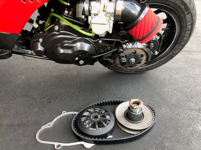

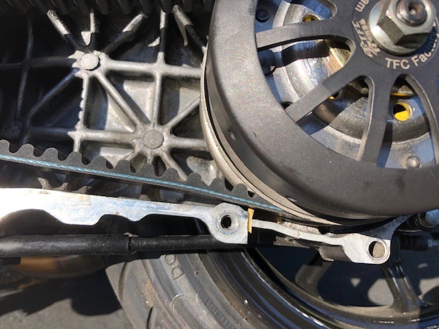

Started a ZX rear pulley swap, looks like I need to grind two areas in my case.

Grind Area

Grind Area 2

Careful twisting the throttle too quick after the ZX Swap or you’ll be flat on your back. Roller swaps are also in your future afterwards. Report back results.

Meatball wrote: Tue Jun 11, 2019 7:34 pm Careful twisting the throttle too quick after the ZX Swap or you’ll be flat on your back. Roller swaps are also in your future afterwards. Report back results.
Wow you are not kidding, I almost lost it on one of the first pulls. It really wants to pickup the front wheel an low speeds, it does feel like I lost some top end speed but didn't have my GPS on, I am impressed!

You did lose some top..its a give and take with CVT. You can get top back with taller gears but then lose some bottom. Just have to find that sweet spot between the two how YOU ride. Do you want high speed 75+...or a torque monster that crushes stoplight to stoplight?

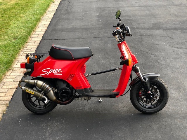

I got the frame brace mounted and ready to weld the bungs to the tube. I ended up machining the the fork mounts out of stainless.
