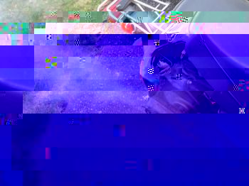

Still smokin comes and goes depends how hot the engine is. Hoping it will burn off
- phppBoxbsPM.jpg (18.76 KiB) Viewed 6185 times
Re: PLEASE HELP!!!! [Resurrecting 1987 SE50 Elite -Ed.]
yeah that is alot of oil you are buring off. is it starting to go away or is it contunuing?

It comes and goes depends how warm the engine is
