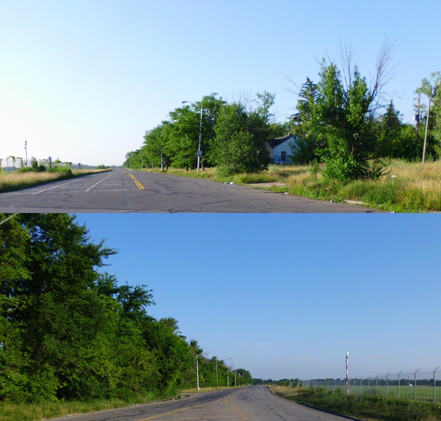

no luck on finding my GPS
the test road where I lost it view from both ends
very overgrown
this area had houses along it many years ago

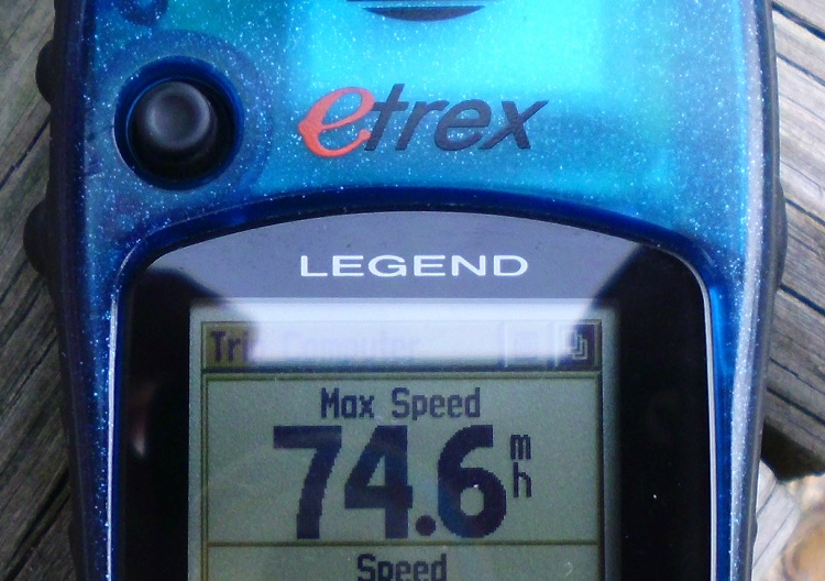

bought a new to me ( used) garmin gps
tried a couple of different tunes
this was the best so far
a lot of repeated info for quicker future refrence
4570 miles on bike
1470 miles on odometer when I rebuilt motor
3100 miles on build to date
new front tire. swapped old front to rear at 4460 miles
so there is 110 miles on front tire and there is 3,120 miles on swapped rear tire
new belt 4255 miles on the odometer so there is 315 miles on belt factory Honda belt
Phongeer aluminum drive face
93 Octane fuel , (R+M)/2.
8.5 gears
24mm Polini pwk carb 123 main jet 45 pilot jet
JJH CARB needle clip on top
new malossi yellow contra spring 1500 RPM
variator weights 30 grams
Humidity:42%
temp 79 deg F
wot CHT hit 365 deg
oko air box
CT intake
polini 3 shoe clutch
naraku clutch bell
Windjammer exhaust
polini corsa 72cc
malossi crank
32-1 premix Klotz r-50
11,800 max rpm
74.6 MPH
need to try some lighter weights when I get a chance
going to try a red contra spring again last time I tried it lost mph
tried a white malossi contra spring not enough crusing rpm
time to work on putting on the disc brake front
edits 7-18-2014 6.30pm
edits 7-19-2014 7.12 am

Thats the fastest I have seen posted on a build that I can remember. Is that on flat ground? I hit 72.3 or so but it was on a serious decline. Thanks for all the details.

it was a flat road the one pictured above took off from the bottom side of the picture
