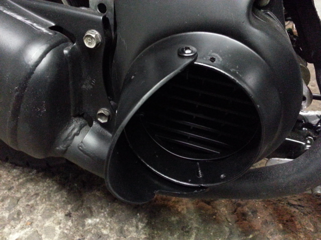

Fearsome heat I coastal Texas. No tune time for Wheelman; the heat just suckered one's gumption. Latest cosmetic mods:

I copied your scoop design and adjusted the carb. no more heating problems.
