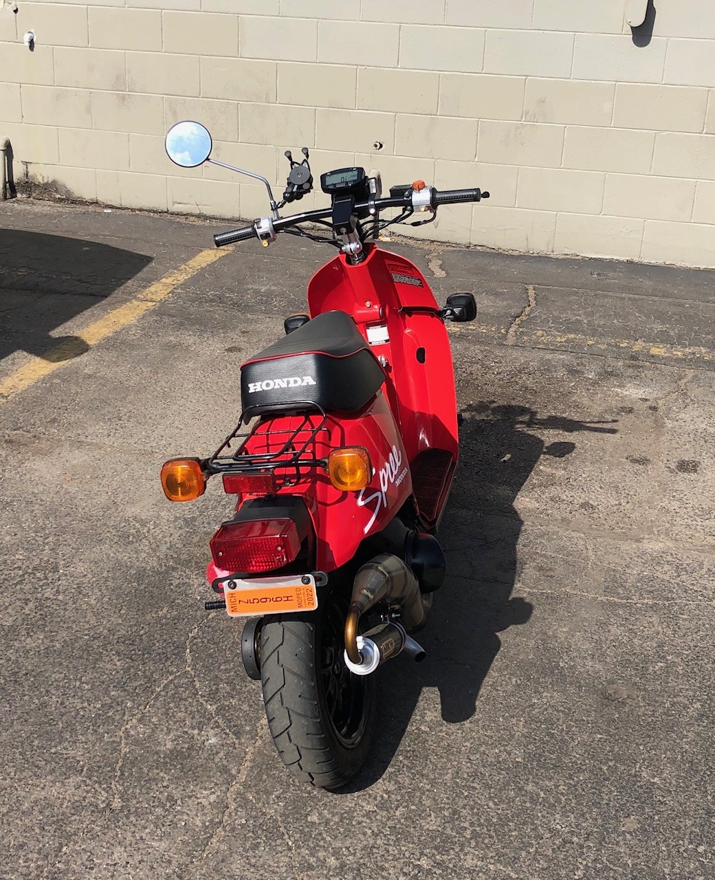

Looks like a ripper! Just keep a close eye on that Arrow. The silencers keep falling off. The mounting tab it hangs from is a weak point. The attachment weld to the expansion chamber is solid but the tab itself is not. Always breaks just below the weld. Gianelli pipe...same issue.

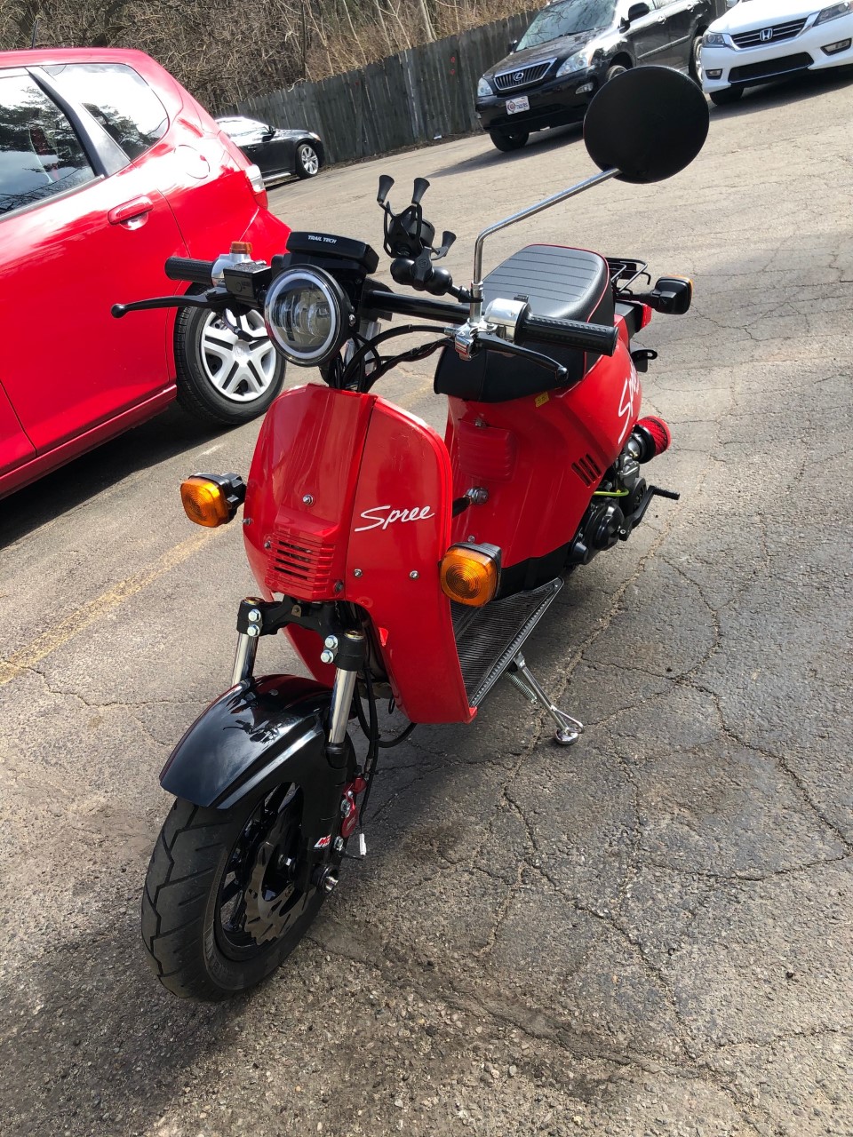

First ride of the year :coolcruise:

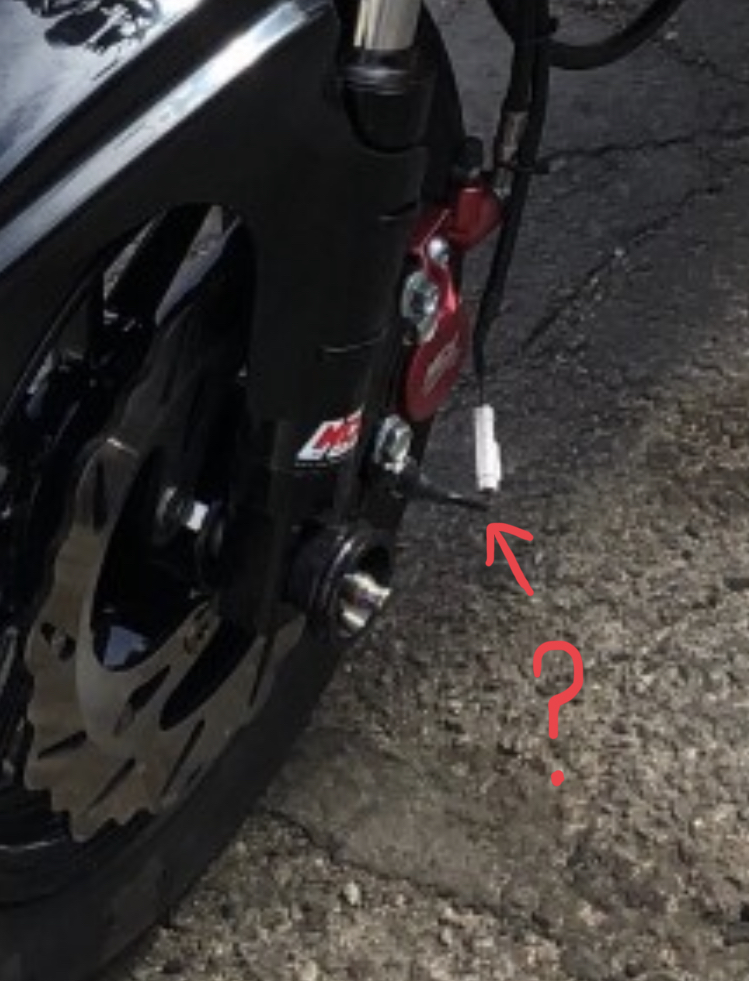

Vapor speedo sensor might cause you headache. Is there no other option? Maybe thats how they all are, I never looked close enough.

Yes that is the prox for the vapor speedo.

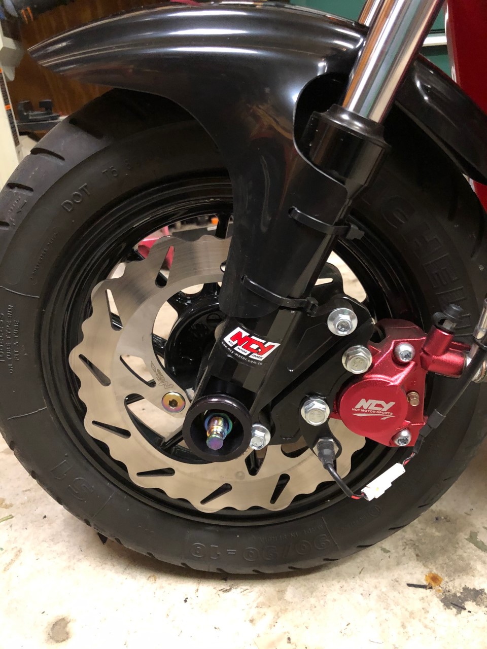

Some updates, new shoes, red fender and floor and a yellow headlight.
