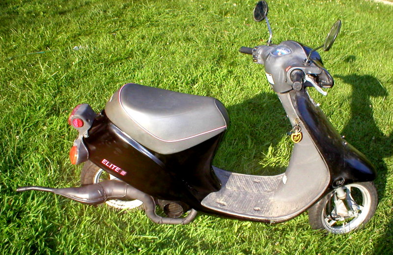

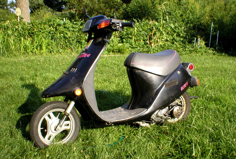

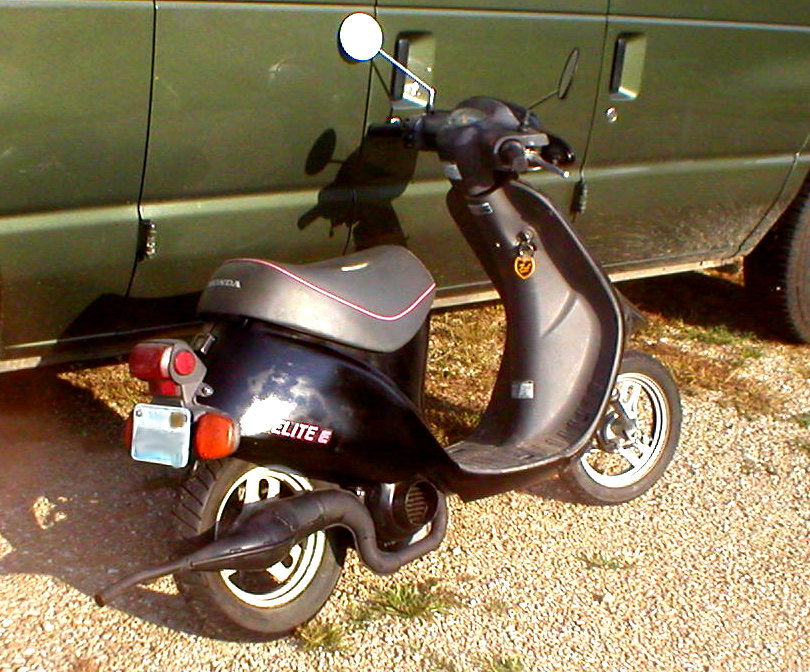

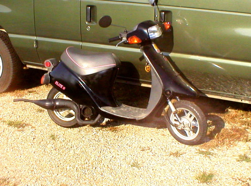

I got some springs for the clutch today. I got them at the hardware store in 3 thicknesses. I tried the .028"x1/4"x17turn first.
I could feel them drag at idle the clutch was not getting nearly as hot but hey it worked. I thought that I should go to the .035"x1/4"x12turn and that worked a lot better still capable of low rpm launching and almost immediate wheelies if held on even riding in the yard. I decided to go with them. The performance is much better than with the .070"x1/4"x7turn monsters that were in there.
I had some issues with rust in the carb float so I dumped the gas and went to work cleaning the tank using some KYB rust remover. Fresh premix and at least I am getting more stable jetting. I raised the needle with shims till It won't run anymore then start back down. My main jet is still rich so I can't gloat on the high speeds that my machine is doing. I can safely say that there is no lack of low end power even with being able to launch at low rpm.
This is my wifes bike mainly. She rides a Buell road bike and a Yamaha dirt bike but still enjoys the scoot. She redid the body so that the engine would fit in. Surprisingly it involved only two notches. She added composite reinforcement behind the fairing in those areas to maintain the structural integrity and to fix a couple of cracks which come with the past 20 + years of being a motorcycle.
Here are some photos of it as it is today. Note that the seat is a couple of inches lower than stock, the rear wheel sticks out behind the bodywork. Lots to do yet.
