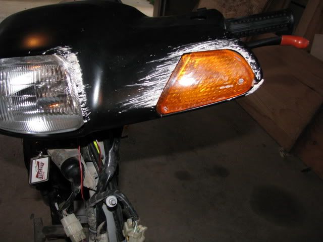

Thanks for bringing that up Chris... Well, I have learned a valuable lesson: over powered elite + loose gravel on the road + trying to be a bad * = epic fail. Luckily the elite is still in the build up phase so the only body panel on it was the headlight cowling. Not much damage to the scoot. Only a broken blinker case and some scratching on the cowling. I think some bondo and some sanding will get rid of the bulk of the scratches.
The scoot took the brunt of the fall followed closely by my left hand. Thankfully this was the only part of my body exposed. There very easily could have been damage to my legs and arms but they were covered. Always remember to wear heavy jeans and long sleeves!
In other news I got my brothers spree working. It starts and runs like a champ now. Oh and Chris, since you brought up this little mishap to the forum my labor rate has gone from $0.00/hour to $75/hour. Bill is in the mail.
