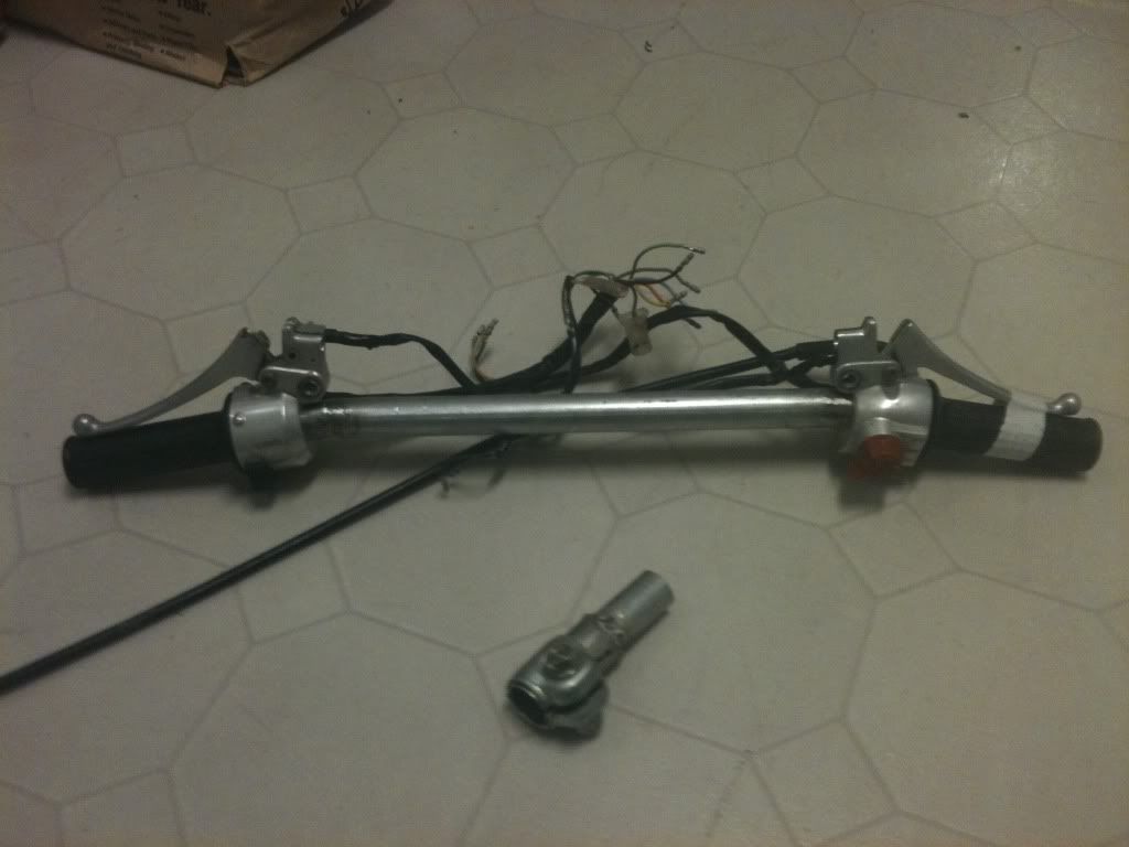

I made some progress since the last time i posted...
here are the handle bars i made

those are some rad bars. i wish i had a scooter i could do that to

Lookin good. I was going do that handlebar setup but didn't want to attract the police with the headlamp setup i planned.

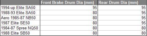

According to Mousewheels chart here, the brake diameter you would need at least a 95mm rear drum to run a hub to adapt that wheel to your scoot anyways.
In laymans terms, only the engines listed w/95mm drum would be able to even try to adapt that sort of wheel and thats only if the rim isnt too wide and hit the engine case. The 2.75 is a maybe but the 4.00 is probably not gonna work. A 2.15 Dio wheel might be a safer bet
