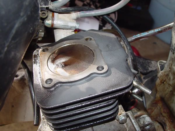

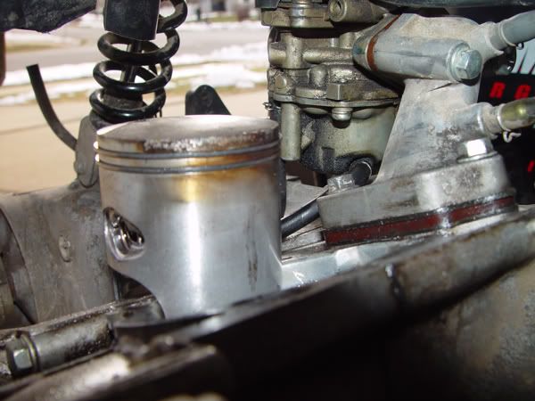

well. tore everything apart as a last resort.
this is what greeted me:
at first, i thought there was just a big puddle of oil on top of the cylinder
further investigation, a good rag wiping, and a few scratches with my fingernail imply that maybe my piston head... melted? i dunno.

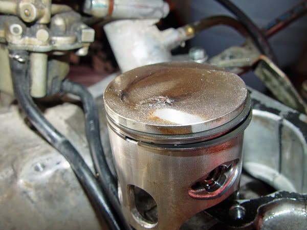

heres what scares me- the exhaust side
(dont mind the dirty carb that the camera focused on instead of the piston)
