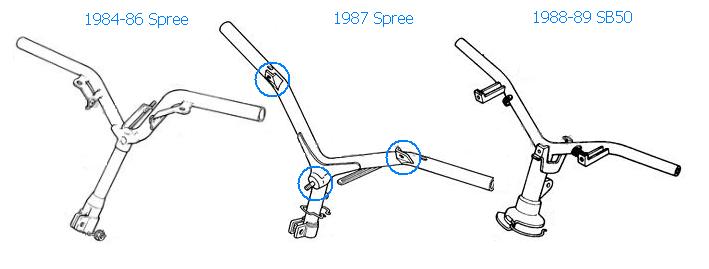

- Front plastic compatibility between 84-86 vs 87 is off because of handlebar differences. SB 50 is different there too. So at the least - someone would need to change the bars if swapping all plastic between 84-86 Sprees with an '87.

And something also tells me that the 87 Elite handlebars may be vary similar to the 87 Spree...Its just a guess tho

The 1987 Elite SE handlebar had different part numbers from the Spree. A look at the parts diagram shows the clamp and base of the bars changed from the 1987 Spree.

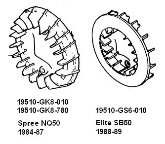

The fan shroud is bigger on the '86-'87 Spree than the the '84-'85 Spree. The late fan shroud does not fit onto an early case correctly; it appears that the casting was enlarged on the later engines. The fan on the later Sprees is not only larger, but is visually different. The early fan supports the blades at the flywheel side only and is similar in design to a CH80 Elite fan. The later fan has a support ring joining the fan blades on the housing side. The flywheel on the later Sprees is physically larger and noticably heavier. The taper of the later flywheel prevents it from being mounted on an earlier crankshaft. Aside from the difference in pulser coils (2-wire for early bikes, 1-wire for late bikes), the stator plate appears to be completely interchangable.
