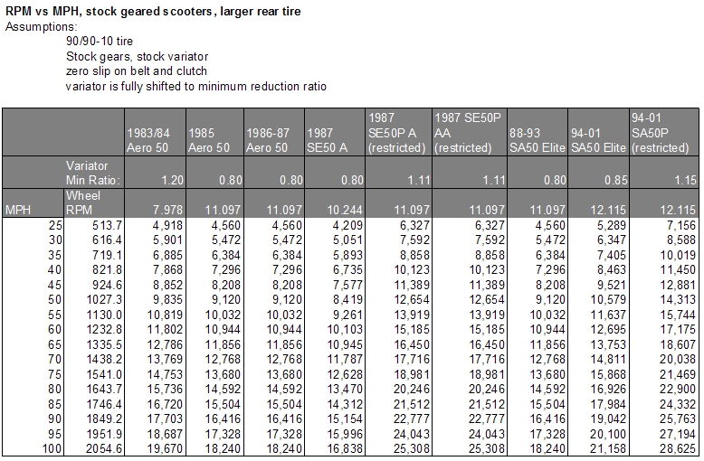

The 90/90 has a nominal height of 3.18". Multiply by 2 and add the 10" rim and you get 16.36. Times pi and you're right at 51" inches circumference, give or take. The 3.50s calculate to 53" circumference.
I actually measured one - can't recall which - with a drop of paint and got 52", so maybe 49" is close for 3.00s but too pessimistic for the bigger skins?
new tire size enteredImage

In the interest of reducing the amount of bad data, the original posts have been edited with replacement table and graph. with notes covering the change.
Where did the problem start? I used 80/90-100 tire dia (398mm) rather than 90/90 (416mm/16.38").
Tire chart used is covered in this thread

Combined gear and variator ratios are on the wiki at this link
-- Edit: added table/graph for stock scooters including AF05 engines.
