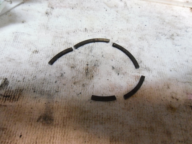

so i got my motor yesterday :geekdance: now i only have a few problems i have to adress and i should be good to go
i am missing the slide and cap to the carb and one of the rings was stuck in the piston even after a day sitting in carb cleaner and an hour in the ultra sonic cleaner plus a bake in the oven at 450 degrees :crazy: , i ended up having to pry it out with a small pick breaking it into pieces so now i am on the look out for at least one standard bore ring for either an aero 80 or cr80
Bear do you know if the cr80 rings will fit in the aero piston and will +0.25 rings be made to fit, both the piston and bore are immaculate so i don't think i need a new piston or rebore

bc117 wrote:so i got my motor yesterday :geekdance: now i only have a few problems i have to adress and i should be good to go
Glad it was received in one piece but sorry to hear about the rings. :oops: My only quick check when I bought it was to see if the kickstart would move the piston.
Glad to hear the internals look good and I look forward to watching your build. Thanks again. :2thumbs:

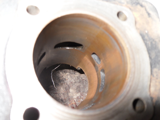

heres some pics

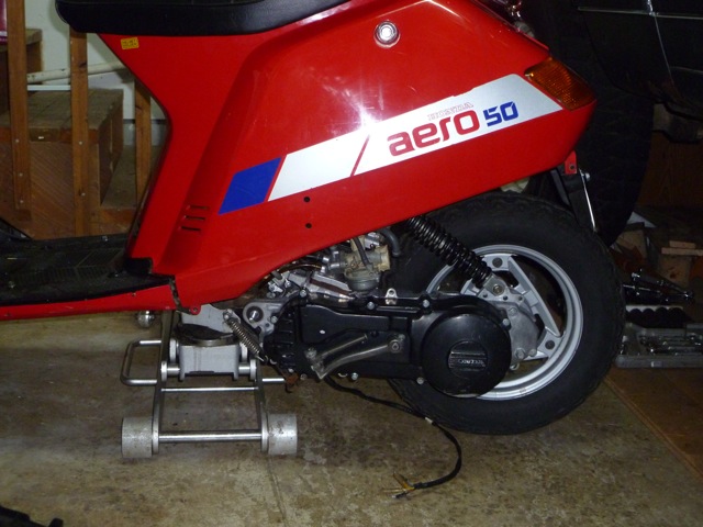

finally back heres my progress so far got the engine in with very little fuss, no frame modification what so ever... yet :nervous: just had to modifify the engine hanger to be wide enough by splicing both the 50's+80's together but now i have a serious ride hight issue :surprise:
