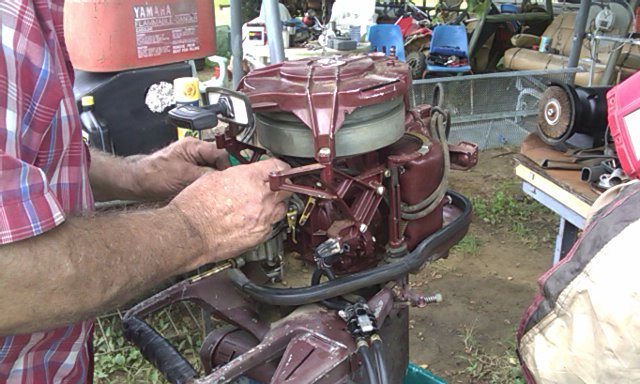

sorry to jack your thread dude but these here pics I took for you bear since your always flashing your crappy old boat motors, this is what I fixed the other day
