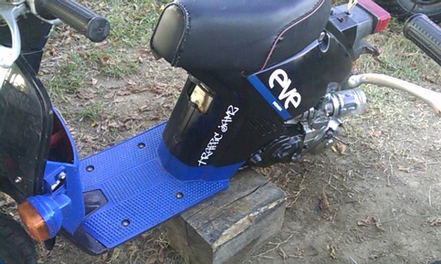

You are a good guy I dont care what other people say about you :P j/k heck yea I will display your decal proudly somewhere. I was thinking of attaching a thin metal plate on each side of my rear basket and put the decals i get from folks that I bought parts from or who helped me out :D Tjamz sent me a kewl decal i gotta find a place for :D I can't wait for the sidestands man, i have a metal pipe with a flat metal piece i bent at an angle that i prop my scoot up with the few times i have rode to the gas station etc, i am so nervous that its going to fall over while i am inside O.o
Mystic
Posts: 2140
Location: Guys, Tennessee
Re: My 86 Eve build
Post by Mystic »
Finally got that 67 VW beetle exhaust gasket TrafficJamz turned me onto, I should have just ordered from that one website but knowing me I had to try and get a good deal with less wait time so i ordered a full set from autozone. got it put on there and no leak :D only thing I dont like is the felpro gasket kits are cheap as * the gasket was metal alloy covered with paper O.o the photo on the site showed solid metal ones what a rip off but hey it works but i can still complain hahha bout to take her for a ride and see how she does. also got the decal from Tjamz on my scoot, thanks again for your suggestions and the assorted jets with the storage case that was above and beyond man.
