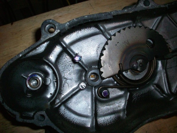

I'm glad to report I had success getting the left crankcase cover removed. I finally found the two little areas where the cover has a tab that sticks out a bit which can be used to pound it loose.
Inside things really didn't look that bad. The electric starter gear mechanism (forgive me for not having proper technical names for these parts) seems to be in good shape, the gear that spins out was retracted and spins out like it should, the whole thing came right out easily after the case was off. (hopefully that was supposed to happen!)
I can see the half moon gear on the kickstart has the second tooth eaten up, it looks like that is the source for the kickstart lockup.
I am guessing that the electric starter quit working and the kid kick started it until he managed to jam this gear and then parked it (in what later turned out to be MY garage!). The reason I assumed the scooter was trashed is because he so willingly gave up the title just to be rid of it, his loss, my gain I guess! I had the spark plug out and turned over the motor by hand and everything seems to be working properly. When the plug is in there seems to be lots of compression which is encouraging. I don't know if anything inside the motor can cause an intermittent lockup, or seize up under compression? I am crossing my fingers that the problem(s) are the two failed starting mechanisms and not the motor.

Looks like you're missing the "castle" gear or is it just not pictured? The teeth are supposed to look like they do, they are not stripped.

evilone wrote:Looks like you're missing the "castle" gear or is it just not pictured? The teeth are supposed to look like they do, they are not stripped.
I have the castle gear, it was in place but I pulled it out to look at the teeth on the gear. It appeared to me that the tooth was stripped but funny enough I was looking at the manual and the gear in their picture looked the same, so thank you for commenting and putting me on track. The castle gear looks like it is in good condition as well.
If that ground tooth is proper as pictured then I guess I am back to square 1 as to why the kick starter is jamming, in addition to why the electric starter isnt turning... Open to suggestions...

clean the grooves on the castle and the half moon and push on the shaft from the outside to see if the snapring is worn allowing the shaft to push in, it shouldnt push in easily or at all if the snapring is good and tight. when you put the castle back in make sure the little washer is under it and you might even put a pea sized bit of grease there then stick the gear in. put the kickstart lever back on so you can use it to turn the half moon enough to insert the castle so that when you let go of the lever the half moon engages the castle and stops where it looks like a tooth is missing :D that is why that spot is there to keep it from spinning to0 far around. good job so far. I would get the kickstart working so you can see if it will crank, you can always work on the electric start later :P that is just me though. also you really dont need a gasket between the crankcase and the cover but you can make one yourself. it is a pain to fool with if you have to take the cover off all the time i finally threw the gasket I made away :D
