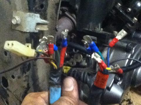

- Plug and play wire harness to engine, starter relay, starter motor, alternator, Ignition pick up.
- IMG_0301.JPG (44.17 KiB) Viewed 6373 times

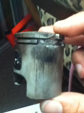

- THIS IS HOW THE STOCK ENGINE FAILED. It was the way I got it.
- IMG_0281.JPG (22.59 KiB) Viewed 6373 times

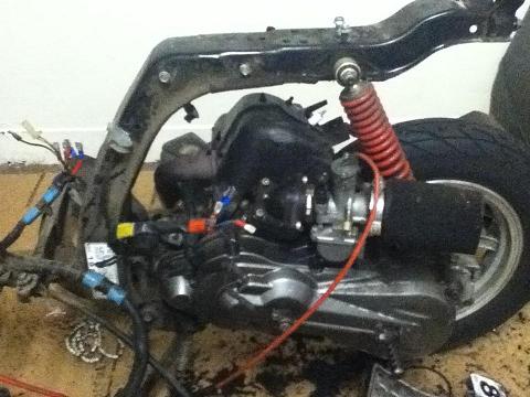

- Sym DD50 engine mounted
- Plug and Play made easy
- IMG_0300.JPG (45.17 KiB) Viewed 6373 times
