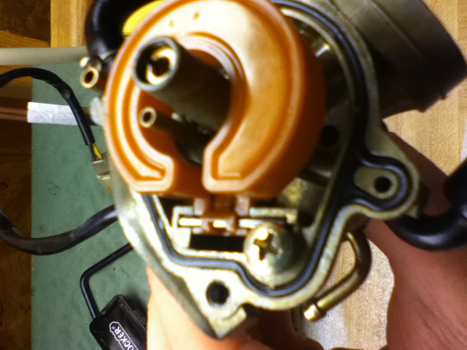

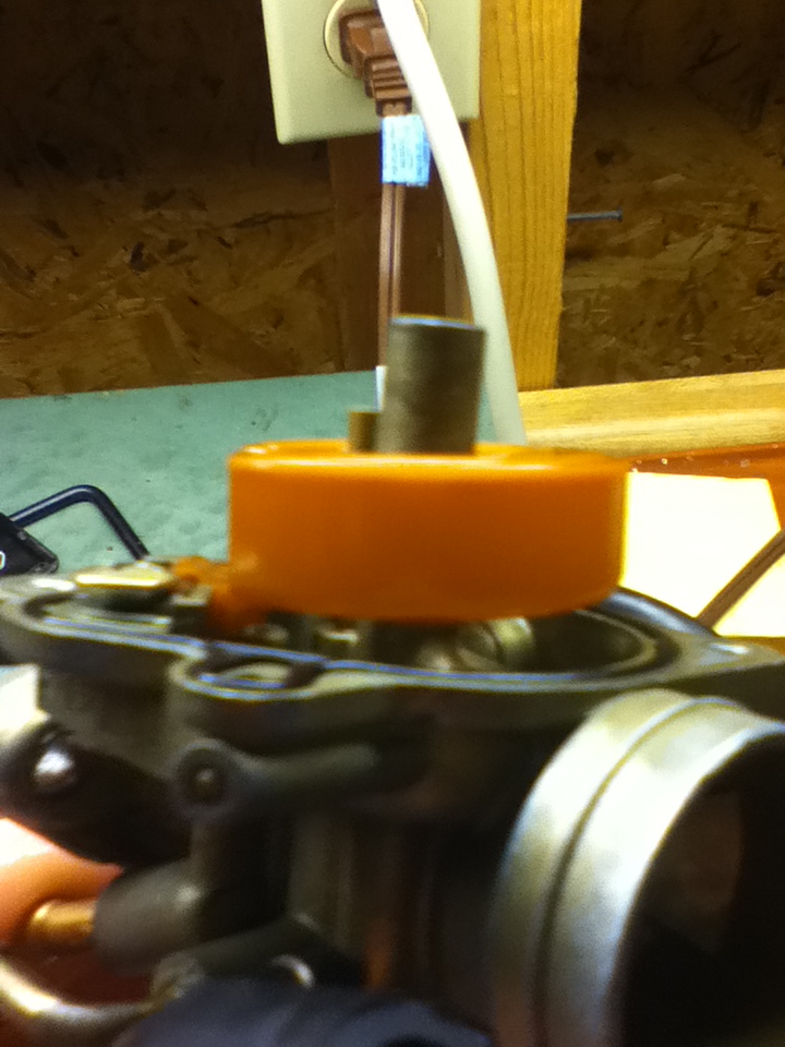

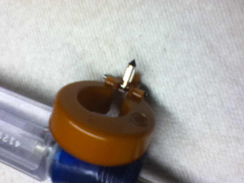

here are some pics guys let me know if it looks right..

'89 Honda Elite SB50p STOCK

Posts: 3675
Location: Iowa, USA
Re: 89 elite wont runn???
Post by eliteguy50 »
Yes, that is the proper way to assemble the float and needle.
