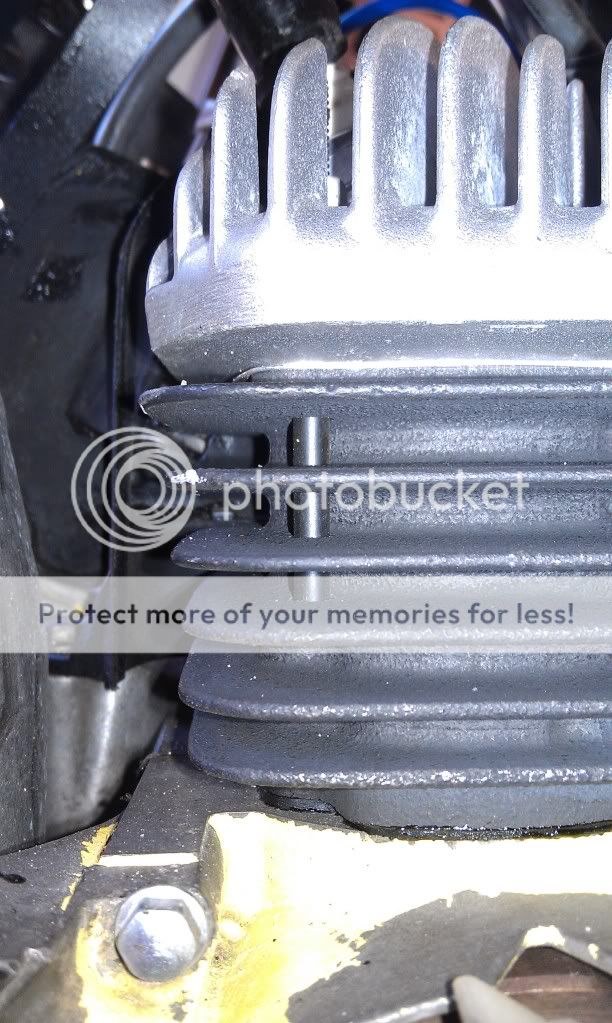

eliteguy50 wrote:Hmm, can you see additional base gaskets? Stroker maybe or stuffer?
It looks like there is only one, but it is hard to tell with all the black RTV. :x
Re: Looking for Scooter Mechanic in Michigan
The base gasket is defiantly thicker than the thin metal one that comes with a polini kit
I also see a metal head gasket :confused: That is strange for a polini kit.
Maybe this scooter does have a ministroker crank.

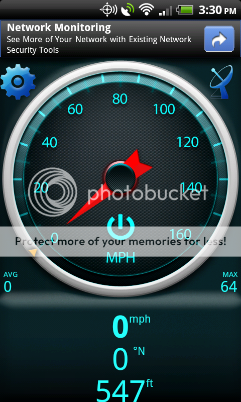

I don't know how accurate this app is......but daaaammnn!!!
It felt fast :2thumbs: 64mph in 547 feet seems a bit out there.
My garmin GPS's battery is dead right now.
I will report back with the garmin #'s
I just realized that 547 feet is the elevation...not the distance traveled. :oops:

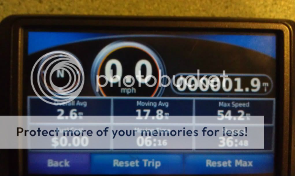

The garmin gave me a top speed of 54.2, but it was very windy during the second test, so I cut the test run short.

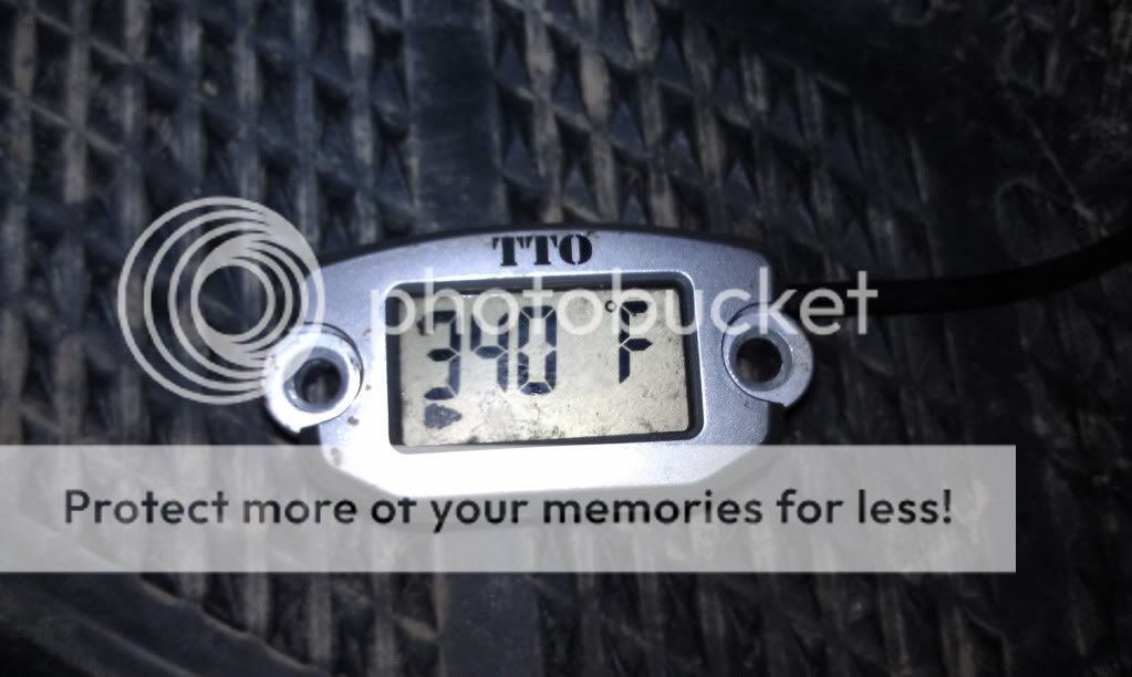

The WOT temps were around 360. Off throttle spikes were close to 400 :surprise:
