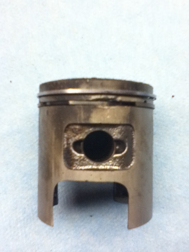

Alright Guys i did a inline spark checker and it passed. (atleast i think the light blinked strong over and over as the engine tried to turn over). So i finally got a compression tester and anfd tested the compression and it didnt even break 15 psi. so i think that the problem.... So should i pull the head and take some pictures and post em and decided whether i just need new ring.. or have to replace the whole thing.. Any advice will be greatly appreciated on tips to working on the top end this is new territory for me but im excited to learn something new!!!

Alright i finaly have the stock airfilter and stock exhaust pipe installed on the bike. the compression gauge is only picking up 15psi max... so tomorow morning i will pull the head before work and check everything ill also post pics. Thanks guys!

My 85' spree wont run????
Here's pics of my top end piston has some damage on one of it too rings.. Do I need to replace it or everything?
- ImageUploadedByTapatalk1332035142.518437.jpg (140.34 KiB) Viewed 6070 times
