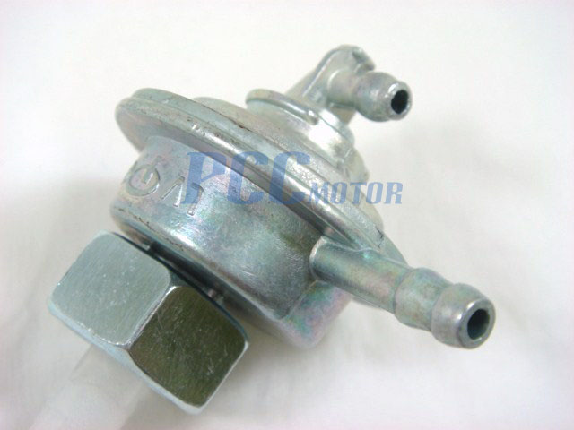

I don't think it is my petcock because if i take the tube from the carb I have lots of gas coming out .Also I did change my petcock.I should have my compression tester tomorrow . I will try to run a test

gas should not flow from the petcock unless vacuum is applied. But if fuel is flowing to the carb. Unscrew the float bowl drain screw and see if fuel flows out.

I don't know I have allot of gas flowing from my tube if I disconnect it from my carb .I also have fuels flows out from my bowl drain screw. This is what my petcock looks like .

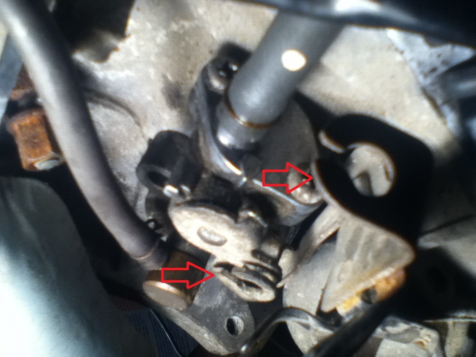

One more thing I just notice that . I was looking in the manual and i just saw that I am missing something on the oil pump . I am missing a cable . How do I fix it ??????????
evilone
Posts: 2991
Location: Portage Michigan
Re: Need a quick help For my friends Honda Elite .
Post by evilone »
Duke250 wrote:One more thing I just notice that . I was looking in the manual and i just saw that I am missing something on the oil pump . I am missing a cable . How do I fix it ??????????
That's because you have the restricted SA50P model, it does not have one. The SA50 has a split cable.

so i don't have to worry about it ? Do I need to do something about it???? . Also I just change my petcock and it is still not running . It is only running for 15 second if I choke it .

Duke250 wrote:so i don't have to worry about it ? Do I need to do something about it????
If you de-restrict it or if it is already de-restricted you should zip tie it open.

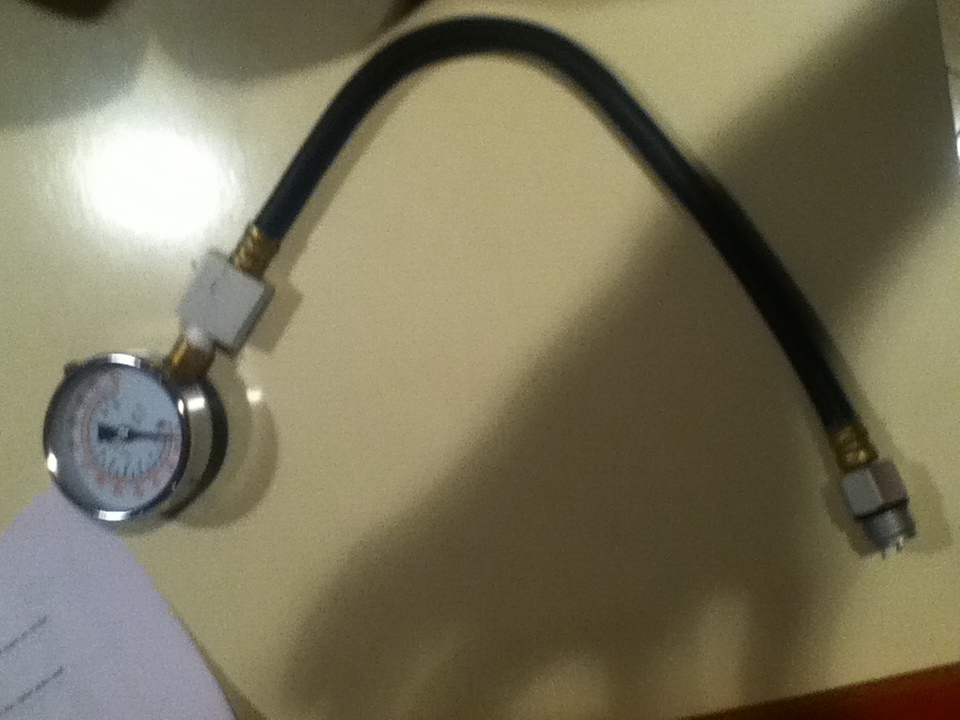

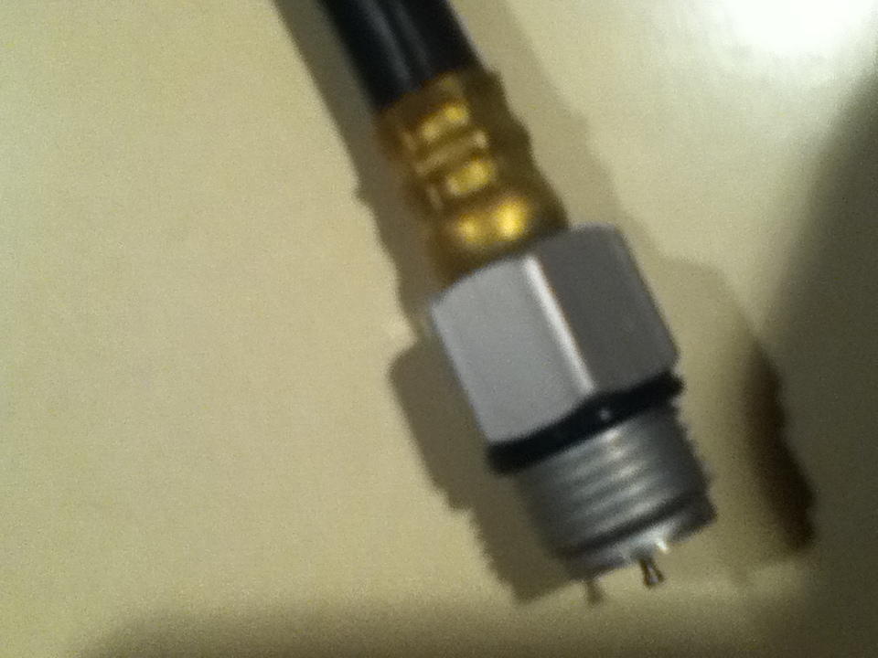

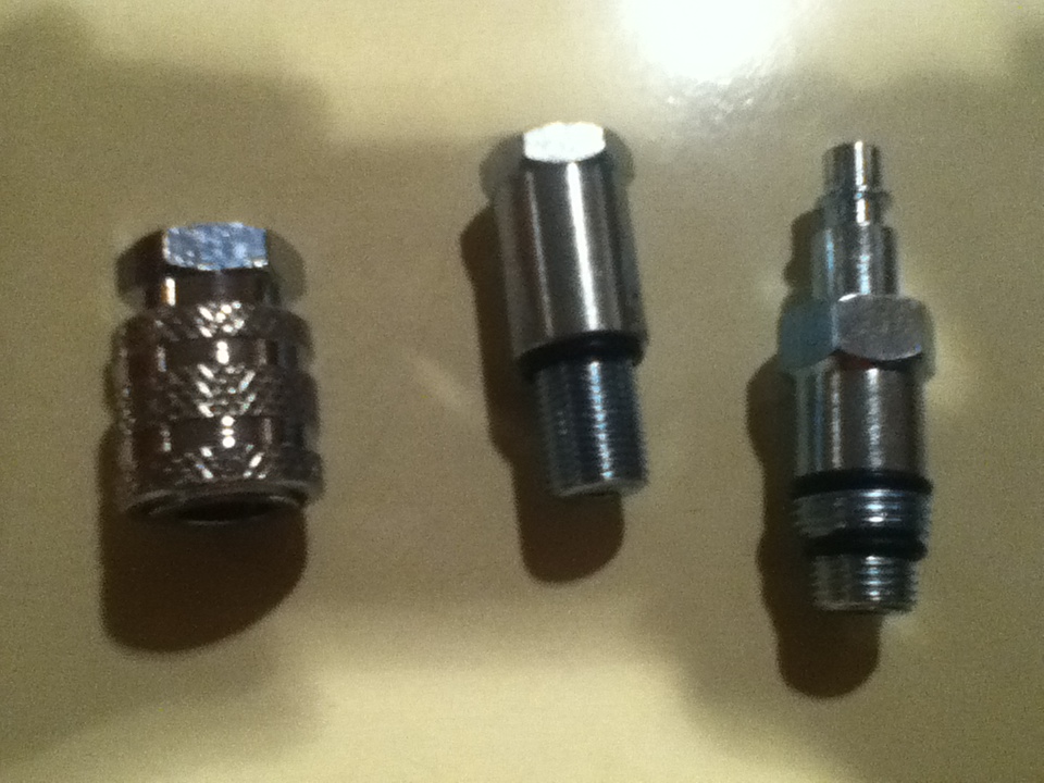

Just a quick help . i just got my compression tester kit today in the mail . I open it but not sure how to do a compression test on a moped . This is what my compression tester looks like
dun rite
Posts: 662
Location: Naalehu, Hi
Post by dun rite »
take the spark plug out. screw in tester until snug then follow this. http://hondaspree.net/wiki/index.php5?t ... sion_Check

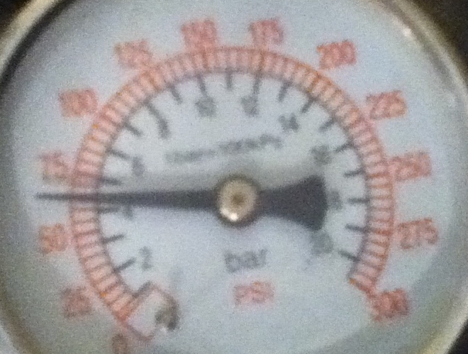

Yep all my problem is I don't have enough compression in my engines. I only have 2000 miles in it . So i just did the compression It is way under 75. I have the picture up . So I guest I need to change my rings? Any idea now ? that is why I couldn't get it running .
