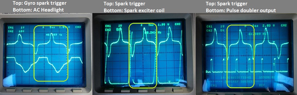

-- Plan --
Double Gyro's ignition trigger pulses. An auto tach set to '4 cyl' (2 sparks/rev) should be scaled correctly.
Pics: Breadboard, and test setup
Scope waveforms:
Far right pic, bottom trace shows the pulse doubler in action.
Note: Top trace - spark trigger signal is 10v/div. It's an issue caused by a divide by 10 probe. So the signal is actually +/-20v peak-peak.
-- Results --
Connected to the tach readings are too high. A Trail Tech Vapor was connected and reads too high. Computing RPM from the scope measurement gives an incorrect result {46hz, 60 and 64hz (~2800-3800 RPM)}. Gyro looks to be more than 1 pulse/rev. I'd like to confirm with a signal directly connected with crank rotation. (a reflective tach).
The Elite mod circuit was swapped in to provide a clean tach input, and Sun tach set for 2 spark/rev.
Photo: Trail Tech Vapor indicates 4k while the Gyro is at idle. Sun tach reads 2k.

I want to verify this, but it looks that the Gyro is 2 pulses/rev. Thus the 4 cyl setting is scaled correctly.
On the electrical side, I'd recommend limiting the tach input signal. The pulse trigger coil measured -/- 30 to 40 v peak to peak in the scope photos posted earlier. The other source - AC Headlight drive goes both negative and positive.
