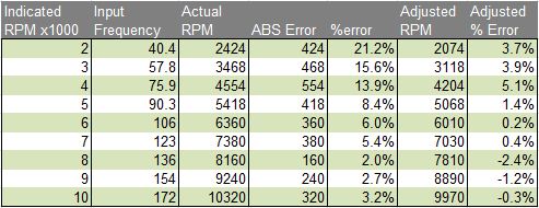

A paper copy of the graticule was printed with the program set for 27mm radius. That radius should fit the 54mm face of the Sun Tach. Roughly cutting out the face shows the program is doing fine at dimensions.
To test the scale, a signal generator was used to adjust input frequency to set the tach pointer line up on each 1k mark of the scale. Results came out with all values off in the "too high" direction. By re-taping the face offset by about 350RPM, the adjusted error was calculated. Worst adjusted error recorded was +5.1%, a better than the original tach check. It showed about +/-10% error on the 8 cyl scale.
-- Results - Tach rescale shows increased accuracy, covers 0-10k vs 0-8k, works with 1cyl 2 cycle engine --

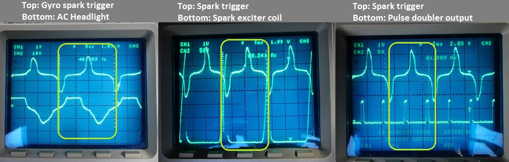

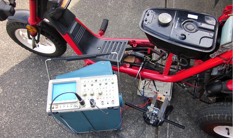

-- Plan --
Double Gyro's ignition trigger pulses. An auto tach set to '4 cyl' (2 sparks/rev) should be scaled correctly.
Pics: Breadboard, and test setup
Scope waveforms:
Far right pic, bottom trace shows the pulse doubler in action.
Note: Top trace - spark trigger signal is 10v/div. It's an issue caused by a divide by 10 probe. So the signal is actually +/-20v peak-peak.
-- Results --

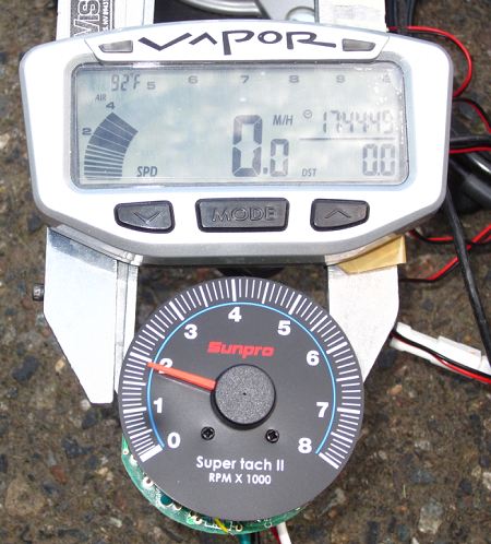

Connected to the tach readings are too high. A Trail Tech Vapor was connected and reads too high. Computing RPM from the scope measurement gives an incorrect result {46hz, 60 and 64hz (~2800-3800 RPM)}. Gyro looks to be more than 1 pulse/rev. I'd like to confirm with a signal directly connected with crank rotation. (a reflective tach).
The Elite mod circuit was swapped in to provide a clean tach input, and Sun tach set for 2 spark/rev.
Photo: Trail Tech Vapor indicates 4k while the Gyro is at idle. Sun tach reads 2k.

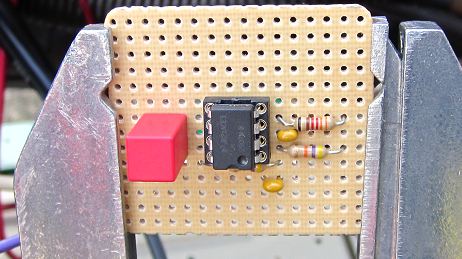

On the electrical side, I'd recommend limiting the tach input signal. The pulse trigger coil measured -/- 30 to 40 v peak to peak in the scope photos posted earlier. The other source - AC Headlight drive goes both negative and positive.
For a pickup from the AC Headlight drive, circuit for the Elite should work. Will test on the Gyro this weekend. It limits the input to the tach to between +12v and about -0.6v. Its small enough to splice into the wires and heat shrink over.

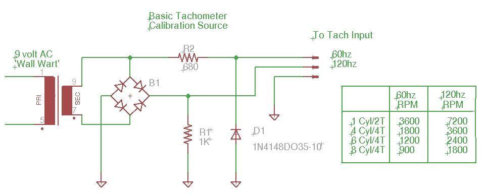

Some low effort calibration sources:

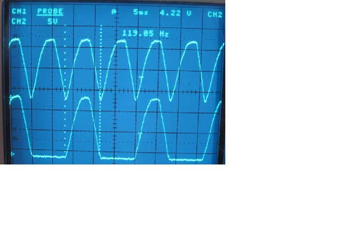

1) Wall Wart cal
Output is 2 calibration frequencies based upon AC line frequency. For a tach set up for 1 spark/rev, output is 3600 RPM and 7200 RPM (or 3000/600 for 50hz AC).
Top trace - 120hz bridge rectifier output
Lower trace - 60 hz half wave output

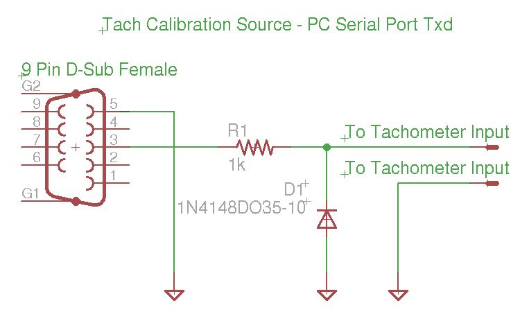

2) Serial Port calibrator
A computer with a serial port (or USB serial adapter) is an accurate calibration source. The serial port clock is crystal controlled.
By changing serial port settings, 1500/1800/2000/3000/3600/4000/6000/7200/8000/12000 RPM calibration points are achieved.
Write up for how to set the serial port, data used and freeware terminal program will be in a following post.
RS-232 signals are about +/- 12v. All that's required is to restrict the negative going signal.

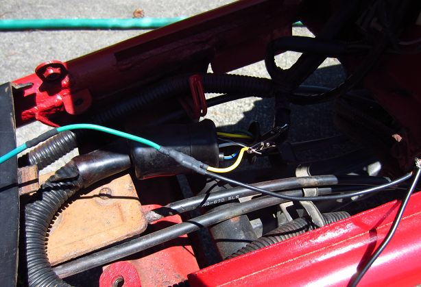

Sorry for the delay. Sun Tach is working with an AC headlight signal source. Set to '4 cyl', no internal mods required.
Couple posts back we were talking about using the parts reduced circuit drawn for the Elite. I tested this on the Gyro today, it works as expected.
This circuit is easiest to build as a 'splice in' to Sun tach's green wire.
Connections:
  • Splice yellow wire to the Gyro Stator Headlight wire (Yellow)
  • Black wire to ground.
  • Green Tach input wire to green wire of tach input circuit
(Not shown)
  • Tach Red wire to +12v switched
  • Tach Black wire to Ground
Re: Tachometer mods
Posted: Sat May 26, 2012 11:35 pm
by gyromaniac
I am more of a visual guy myself. I have a hard time picture how to do something when some one puts it in words. Could you post some cloe ups of how you hooked the gyro up to the sun tach. Sorry for the inconvienence.
