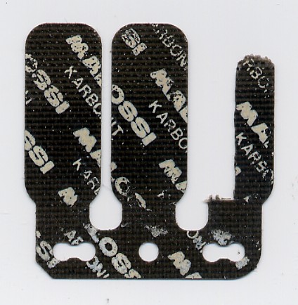

It's been over a year and about 800 mostly wide open throttle miles since I installed the BBK.
I had my first problem recently, which turned out to be broken reed petal on the Malossi carbon fiber reed that was supplied with the BBK.
2013 07 12 2051 SA50 reed.jpg (55.32 KiB) Viewed 9083 times
"Funny" that I held that part in my hand when it was new out of the box, thinking, "I don't really need this", questioning its durability.
Safe to conclude that when your air filter is saturated with gasoline, your reed has failed but I went ahead and did a leakdown test before I removed the reed block.
Back to the stock Honda reed petal and we're good as new, although I don't EDIT: do want to try to find a Boyesen dual stage reed, which were always good to me in my dirt bike days.
