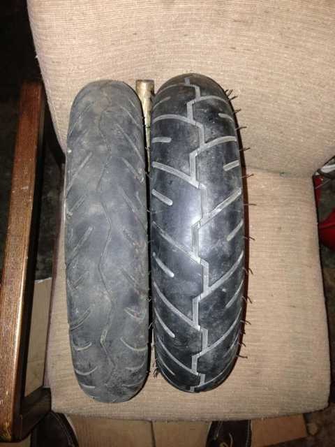

I have swapped both front and rear wheels to metro wheels with the bigger elite front brake. Brand new oem front brake line with new slotted brake shoes.

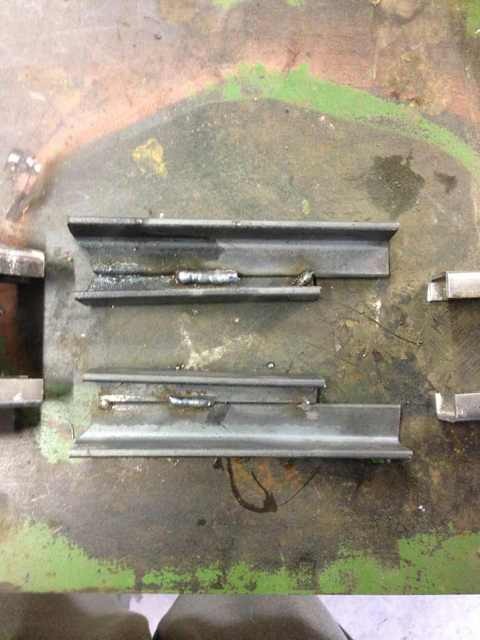

Went with a 5 inch stretch on the motor mount and relocated the shock back to keep the same angle as stock

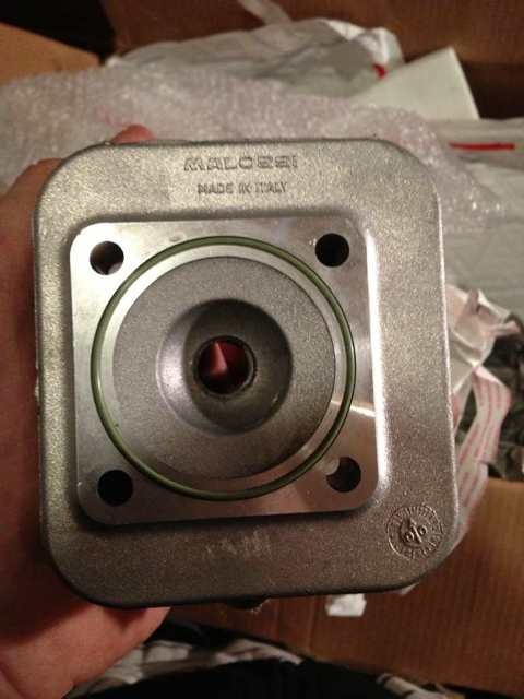

Thanks to a member here I got lucky enough to snag up one of the discontinued 65cc Polini BBK on eBay for a steal. Cleaned it up when it arrived from Italy did some cleaning of all the ports in the outside of the jug didn't mess with inside or exhaust raising, I did clean up a lot and polished the exhaust port and flange dust take pics I guess maybe next time it's off. But here's installed
And I'm using a Malossi O-ring top end

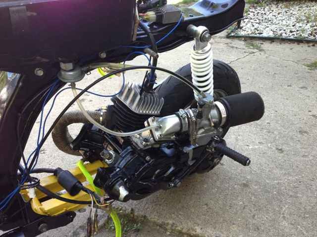

Did some dremeling of the stock reed cage to make a spacer so I could use the ct chrome intake with the 21mm flat side OKO and UNI filter.
What I'm at for jetting at the moment is 110/40. Starts first kick and idles good sounds good through out the throttle but is maxing out at about 40 GPS. Pretty sure I need to add a couple grams to the variator load. Using 6.2 polini rollers now, I think I need to be closer to 8s to really take advantage of the high reving polini. She's hit 9k on the tach already!! Being careful with stock stock gears.

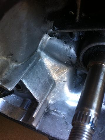

Running a stock ruckus variator had to do some slight shaving if the case to give it some room but nothing serious. I'm using the malossi special belt little wider and little longer I believe. The teeth are completely different at least.
