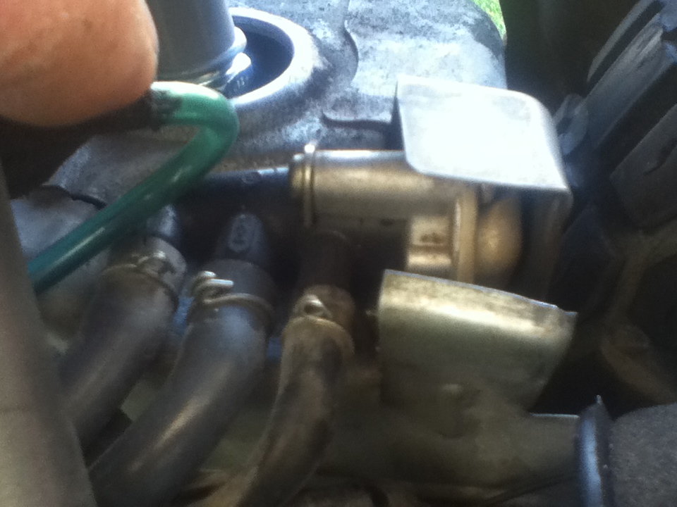

If the control box is gone and a pump primer is in its place, that would indicate the PO attempted to bypass the system but used a primer bulb instead of a fuel shut-off valve. This could easily be part of the problem in that it may be able to pump additional fuel into the mix but probably wouldn't shut-off that flow completely. The warmed up engine will not run well if this system does not shut off. Here is a pic of how it should have looked originally - the part circled in blue is actually a small air filter and has an element that should be inspected/cleaned or replaced. The 2 hoses coming off of it feed air to the carb (simple venting) and to the control box. The 3 hoses on the control box are (from left to right) output to intake manifold, input fuel from carb, and input air from that filter.
The concept of replacing this system with a manual choke is to bypass the control box by running a hose directly from the carb fuel supply to the intake manifold. In order to shut that flow off when the engine warms up, you place the fuel shut-off valve in that line. Sounds like your PO placed a bulb primer in that line.

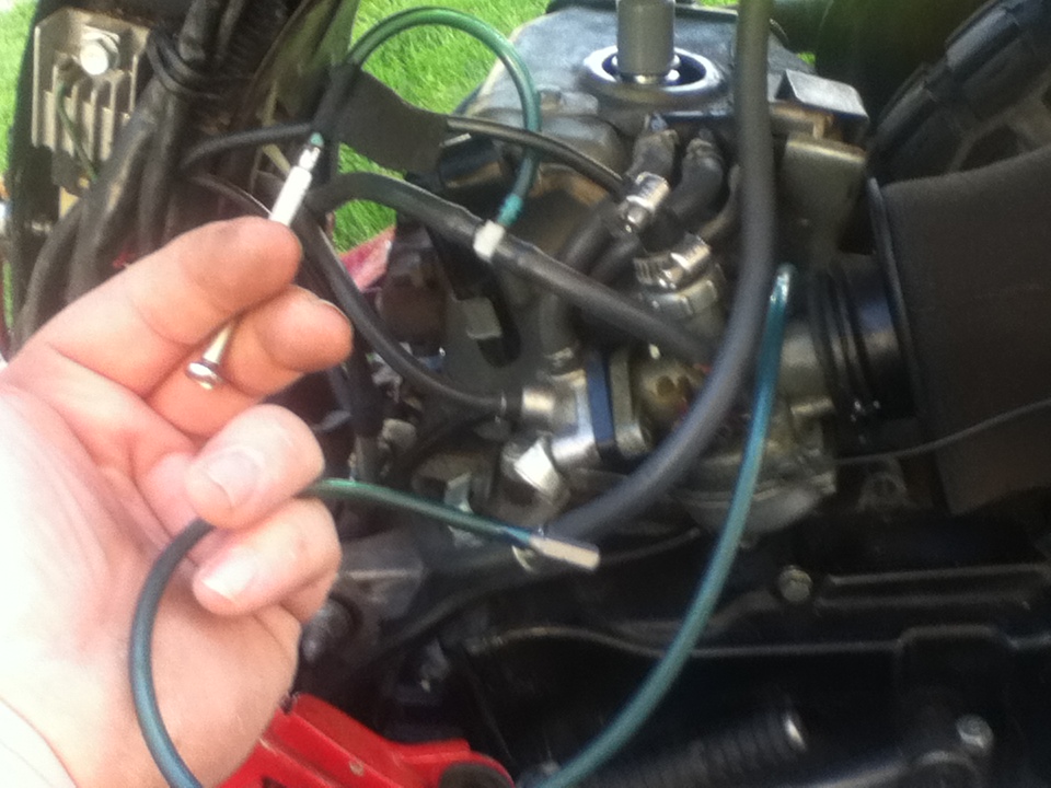

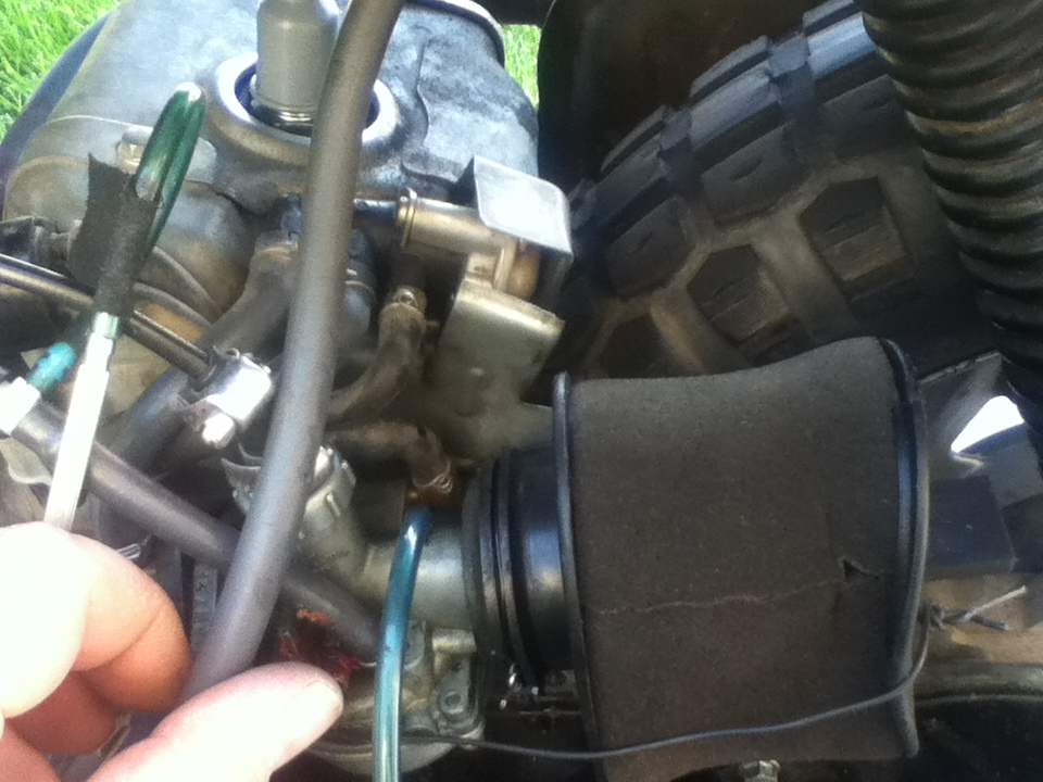

wow. that's detailed info. thank you very much. I was actually meaning to post pics this afternoon but found myself out in the garage staring at the same hoses you show here. I assumed the bystarter would be oriented in a different location. Looking at all this information, I realized 2 things: 1)the entire bystarter system is present on my Aero80 and 2)It has to be bypassed because I get a headache everytime I look at it.
I'll try to use my Ipod to get some pics up while the light is good so you can see the mess. I may find it easier to just post the link to a video on youtube. I have what appears to be a complete bystarter AND a vaccuum operated primer. How I am getting even 65 mpg I do not know, unless it is somehow stuck in a closed position.

limited to 3, so here's the 4th, :)

the new sparkplug boot is my addition. the rest of the rat's nest is how I got it. the little ngk nipple inside the existing plug boot was pretty chewed up and I wanted a better connection. I got this scooter for $350, and before I get laughed outta here, I bought what I could afford to get my butt to work after finding a job. Now to bandage her wounds and get her all better, yes?

I pulled out all the lines (blue ones) for the improvised primer. It was sucking gas constantly. The bystarter appears to work just fine after I cleaned some orangey goo out of the thing it sticks out of (I had expected it to poke down into the carb, but it sits sideways, up above it, into some module or something.) I also put in my new plug boot and a shiny new .28 gapped ngk plug. I put the cheapass 2 stroke oil out for recycling and went to carl's cycle here in Boise and got the honda stuff. Bear said lose the premium, so I fed the rest of that to the lawnmower and filled with regular. altogether, she is up from 38 mph best to today at 42 just briefly on flats, consistent 40. 2 solid mph and less fussy on low speed acceleration. still doesn't idle for crap till warm, and won't idle for more than maybe 5 minutes before just shutting off if I fail to blip the throttle occasionally. I still have some carb issues, obviously. I'd like a 21mm as Bear suggested, with a manual choke that sticks right the * out of the top of the carb. Now, this racing dio intake, is it 21mm as well or do I need to grind it some? I understand the two must be the same diameter, carb and intake?
