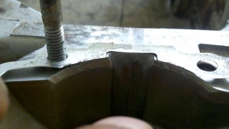

kingkamehameha wrote:Crank needs to be taken out anytime that you do port work. If your compression is at 155 you will blow a hole in your piston with the pump gas
only did very minor port work and only on upper portion of boost port. i just soaked some rags with oil stuffed them in the crank area, flipped the block upsidedown, and used a small file and very frequently wiped out all the filings as much as possible.
Corsa boost port not much bigger than stock so not much to clear.
- 2012-07-08_12-21-09_750.jpg (20.08 KiB) Viewed 6956 times
Re: DD50 corsa
kauaianman wrote:kingkamehameha wrote:Crank needs to be taken out anytime that you do port work. If your compression is at 155 you will blow a hole in your piston with the pump gas
thats not porting ...
boost port helps in cooling the motor as well...
- kingkamehameha
- Posts: 1005
- Location: kailua kona
Re: DD50 corsa
Boost port needs to go straight down thats why the case needs to be separated an crank taken out. I doubt your getting hot because of that. You need to do a correct pressure test on your motor and then get back to us

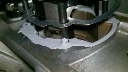

the other day that minor leak on the boost port was bothering me so i pulled the head and put hondabon on with the aluminum base gasket.
sopme pics
sopme pics
- 2012-07-11_21-08-13_919.jpg (24.43 KiB) Viewed 6943 times
- 2012-07-11_21-07-47_410.jpg (23.89 KiB) Viewed 6943 times
- 2012-07-11_20-54-54_914.jpg (23.42 KiB) Viewed 6943 times

made sure hondabon was even all around.
- 2012-07-11_21-11-17_100.jpg (24.59 KiB) Viewed 6943 times
- 2012-07-11_21-10-52_788.jpg (21.19 KiB) Viewed 6943 times
