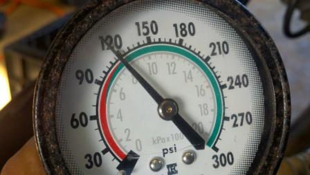

the other day that minor leak on the boost port was bothering me so i pulled the head and put hondabon on with the aluminum base gasket.

after putting the hondabon i used only original corsa O-ring head gasket and got 150psi compression
tried it out and ran hot so i pulled the head again and used a regular size head gasket with the corsa O-ring and compression came down to 120.
still running hot.
no leaks comming from base of cylinder at all.
