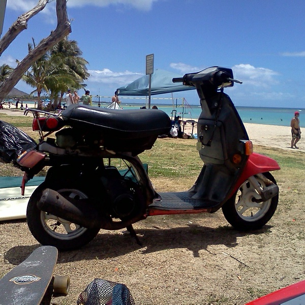

It is a AFO5 with a leo vince pipe! nice score :wink: I have a few of those panels. Which ones do you need?

Sweet thanks for confirming. How do know its leo vince? I thought it was a v8 this whole time.

Re: 1985 Aero needin some help.
The scooter is either NOT an '85 Aero or it has a transplanted engine. The '85 Aero had no kick starter and a two bolt intake like the Spree. This is either a '86 or '87 Aero or like I said a transplanted engine. What is the VIN number? The muffler is not stock but does not look like a Leo Vince SP3 to me, at least not like mine.
Post by SpamMusubi4Life »
Well the person I bought it from said his son swapped motors cause the first one crapped out on him.
Post by MopedMark »
Looks like a AF16 based on the kickstart, cooling shrouds, and airbox set up.

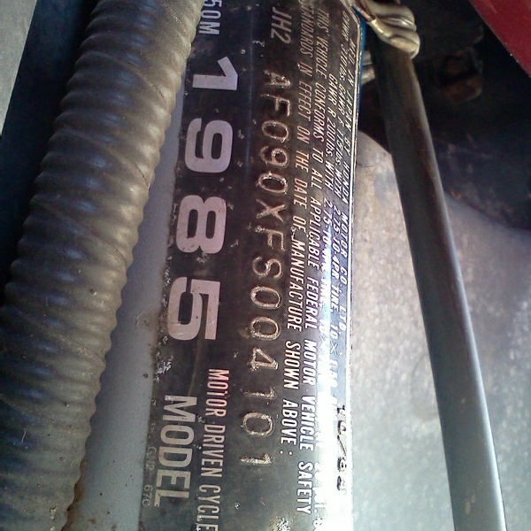

Alright stupid question but where is the vin # located? Sorry for the noobness.
On the front frame up right right behind the front wheel, usually on the right side.
Got it!
Yeah, that is a 1985 Aero 50 VIN number so the engine is a transplant.
