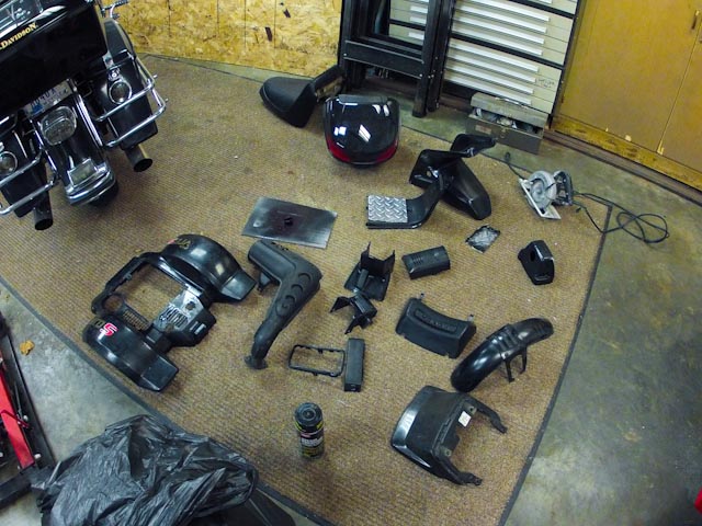

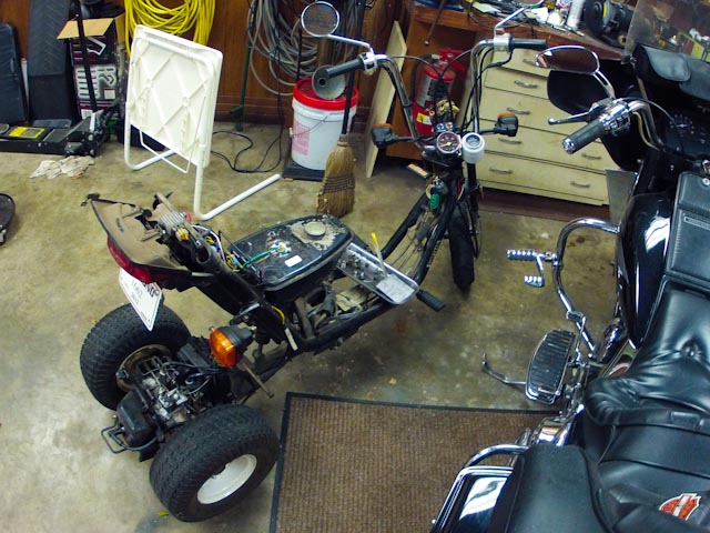

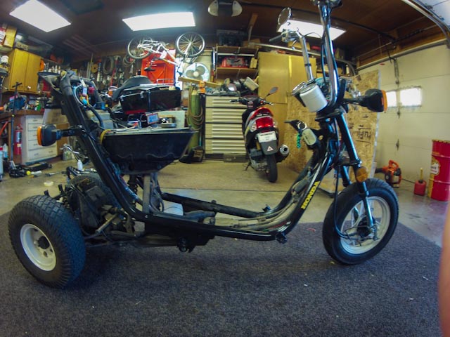

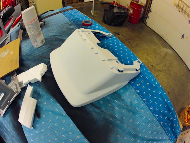

Well I've had to put my painting on hold for a day or two. I've got a nasty cold and cant seem to shake it. here are a few update pictures though of the bike stripped down to make up for the delay

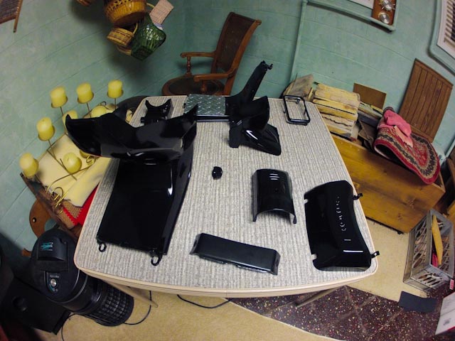

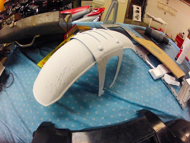

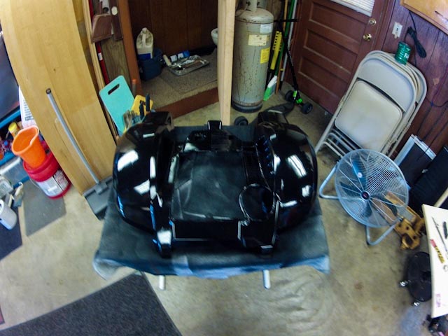

We the first batch of parts is now done. Word of advise, don't buy Rustoleum clear for plastic. When i used it, it dissolved the black paint. Luckily it was only one part. Its been repainted since. I have started filling in the scratches in the rear fenders. Also have some paint issues to deal with on the front fender. other than that, everything should be done and back together by the end of this weekend

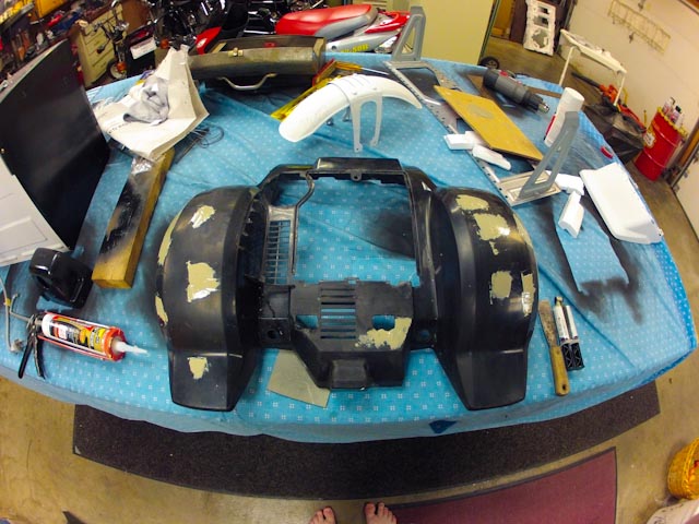

Post by gyromaniac »
rear fenders

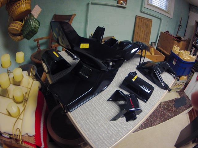

Almost done. I have applied most of the stickers and done some detail lettering. just waiting for my fenders to get done so i can add the stickers and start reassembling everything.

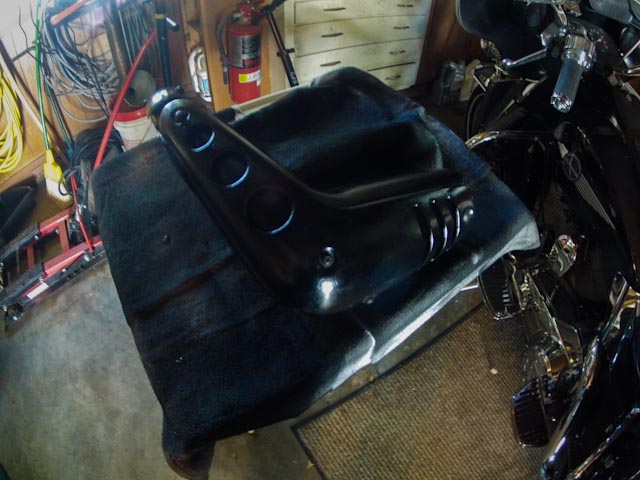

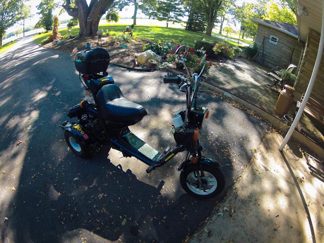

Well she's finally done. Got her put back together today. i went ahead and repainted the muffler. Unfortunately she wont start and i have no clue as to why. No spark at all. It turns over just fine but no spark. Looks like I'll be dumping more money into my bottomless money pit.

I used Rustoleum Primer filler to fill in the plastic. Its a very thick paint. Alot of people suggest using a paint adhesion promoter to help the paint stick (its basically spray on glue). It would probably be best to use vinyl dye paint for plastic as it doesnt just cover the part on paint. It dyes it the color so even if you sand it the color doesnt come off.

For big cuts and gashes I use bondo
