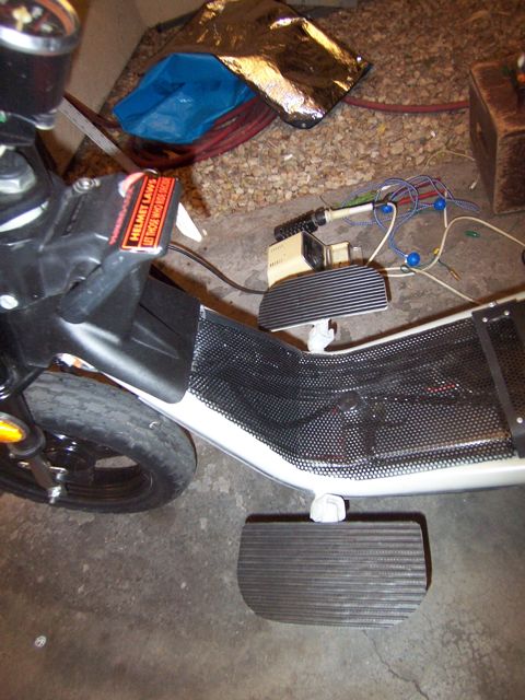

As for the floor plate I made one out of perferated metal I just used an old one for a template
and it came out quite good I also used some aluminum on the bottom of the frame as a skid plate
which also looks kinda good I think ? I just used rivets to attach it .
It was pretty easy .
As for the headlight housing thats a real pain I had some like yours and I used some metal tape
on the inside and just used JB weld and would build it up slowly like keep adding a bit at a time
then after it looked OK sand it down to fit . I have tried to use other headlights like chrome bullet ones but the problem is the wireing
harness has to fit inside and it gets kinda tight .
Carl really you should think about just making your own floor panel .
Your Gyro is coming along very well and looking forward to seeing it when your finished .

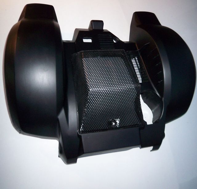

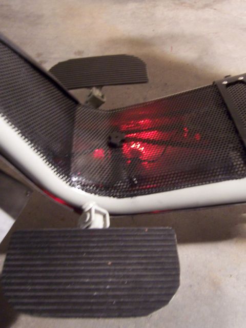

I also made the engine cover out of the same stuff . You can laugh at my foot rests but with the stock ones they vibrate
a lot when rideing with mine they feel good and no more vibration .
- 100_9647.jpg (52.55 KiB) Viewed 12948 times
- also stuck a red LED
- 100_9651.jpg (43.79 KiB) Viewed 12948 times

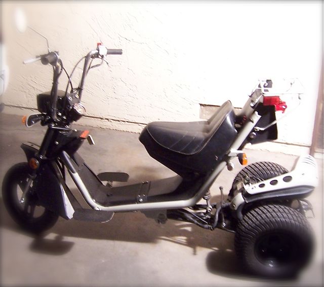

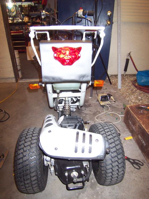

Re: Noob with an '85 Gyro
You might want to check out Wall-mart yes Wall Mart has some cool looking tires that will fit your Gyro and they are very inexpensive
I think under $20.00 per tire . They are for small carts or tractors but they do fit a little tight but the tread looks cool .
If you decide to go with them a small spacer between the frame and fenders will help and the tires won't rub .
They sell a headlight at Harbor Freight that is chrome but the lamp is only single beam (look in the trailer section ) also not too expensive
the problem is there are a lot of wires you have to stuff in there ,I am always on the look out for a cool looking headlight or what would be really hip is too find one that the speedo and indicator lights would fit into . Oh well thats just me . And I will probably paint a set of Gyro wheels yellow like yours and if anyone asks I will say I saw a guy swflcarl do it on this site.
Hiya Carl...
66SIX can reply as to the spec he is using...
His choice is a "turf" tread design. (13 X 500 X 6) is a tidy fit under the fenders
My choice for the rear of TG50M Gyro is (15 X 600 X 6) Running fender-less
...and because I race mine on pavement, I have chosen to use a "rib" tread design.
Both tire designs are meant for the front of lawn tractors, primarily...
I buy mine at Northern Tools or Tractor Supply or Lawn-mower stores.
WalMart probably hard to beat for $$....I just stay as far away from that store as possible.
You should test-ride your own set-up to find optimum pressures.
I suggest the pressure on the tire sidewall be ignored.
I run only 11-13 psi for race purposes.
Something like 20-25 psi might be good for street/yard use.
The cornering will be greatly improved over those narrow tires you are running now.
Mike my mentor.... thanks for the advice. $32 for a pair - can you say cheap.
Went for the 15 x 600 x 6
Excited about my race slicks.... okay lawn mower front yard rubber.
They are in the back of my sled... will attempt to mount this weekend when I am home. Let me know any tricks if there are any.
Thanks again my friend.
