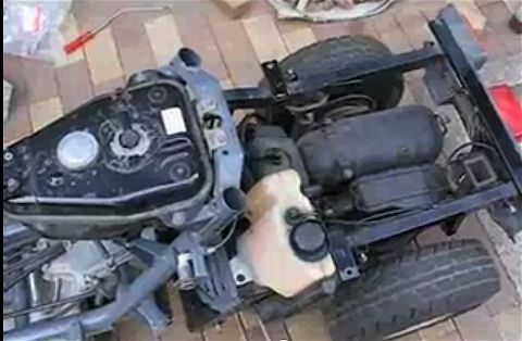

I am not sure but I bet your frame will look a lot like mine ...?

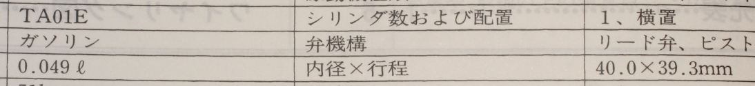

Double check your GyroX is a TA01E engine. This is info I found on the TA01E.

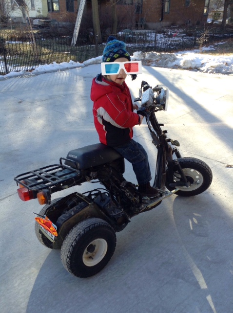

Attached is a pic of said Gyro X with my young'un ready to carve.
Ok, got the Gyro X on the road. I ended up using a Honda Hobbit 40mm piston and matched it to the cylinder skirt. Worked great. Plastics are off for now- they are not in very good shape, so I may leave it skelly... I dunno. Fun fun fun bike. Way more stable than the US Gyros (back end actually stays on the ground), plusher(?) shocks, better accel. I am looking forward to some snow with the rear differential and CVT! I am going to try to fit a Leo ZX on the stock cylinder and see how that does.
I did some investigating and the Gyro X cylinder (for the TA01, TA02 engine) is the same as the Japan/Euro-spec Lead 50 NH50 (AF01 engine). Also the pre-1996 Honda SH50. 40mm bore 39.3mm stroke. Malossi and Airsal both make kits for those bikes, so I will pick one up when I have the chance and report back.
