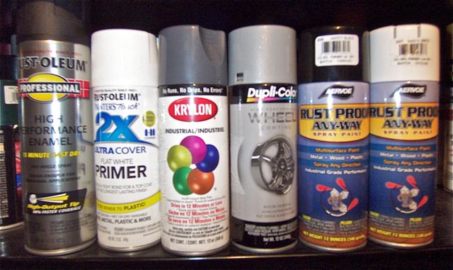

Wowowowow what am amazing restoration. It's so nice to be able to see the process that the scooter goes through. AND for only $20?!?! What a steal of a price! What's your paint method? I'm assuming its not just a spray paint can kinda thing, looks really nice. I'm blown away by what you have turned this scooter into!

As for the paint I did use spray cans because mixing paint and using a gun can get really expensive really fast $90.00 or more with the catalist for a quart and they hate to sell smaller sizes . I have a gun and compressor but I just like cans as they are fast and look just as good ,I did use some special paint and it was not expensive under $4.00 a can but it is hard to find I had to go to a place that sells steel I got some stuff thats made by AERVOE Rust proof Any-Way ....you can spray upside down and the paint is a bit thick so it fills in some of the small scratches and drys glossy and tough I also use Dupli Color for rims & frames It's a bit pricey $9.00 a can @ Pep Boys I also like some of the Rustoleum paints but make sure and get the high performance and professional stuff ... This also sounds goofy but I found some sanding sponges at the Dollar Store that worked out great on curved surfaces I was surprised and even went back and got more . :
