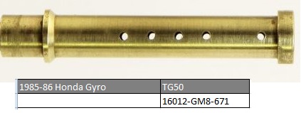

-- Emulsion tube visual identification --
Note: Only the Elite Unrestricted tube is shown. It has two sets of holes at 90 degrees. Pic shows both views
Note: Aero has two sets of holes at 90 degrees. Pic shows both views
Note: Sporee has two sets of holes at 90 degrees. Pic shows both views
Note: Gyro has only one set of holes

mousewheels wrote:-- Emulsion tube visual identification --
The emulsion tube with the most holes is the unrestricted one, yes?
The part number indicated is the restricted or unrestricted part number?
Thanks. :thumbwink:

Re: Honda OEM carb info collection
Thanks - I've updated the posting to clarify. I have only a un-restricted emulsion tube and its got two sets of holes.

Do you think there is a big change between a restricted and an unrestricted emulsion tube?
I have a restricted Aero. It has been derestricted by the ramp plate and the washer in the pipe.
I have not changed anything with the carb though.
Was wondering...
Sorry - still something I'd also like to know. I have not yet had a emulsion tube from a carb with the id tag from a restricted scooter to compare.

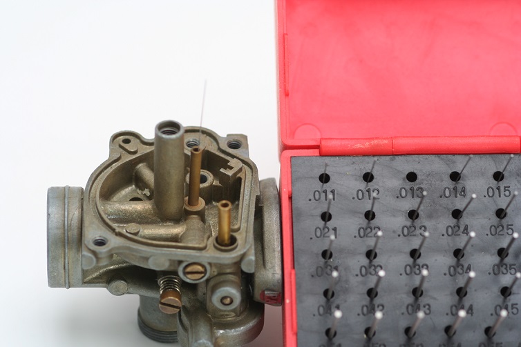

Pilot Jet orifice measurement (approximate)
Using a set of pin gauges (seller says accurate to "-0.0002")
I found anything up to 0.013" would pass through, and the 0.014" would not
0.013" is about .33mm, The 'nogo pin' at 0.014" is about 0.356mm
The 0.013" pin is has some wiggle room, so 34-35 is a reasonable figure for the Spree pilot.

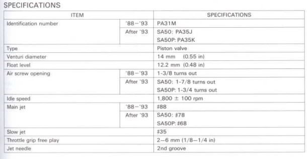

Pilot Jet size - from other Honda Scooters
The Honda Elite 1987 SE50 manual documents the 'Slow jet' size as a 35
The Honda Elite 1988-2000 SA50 manual also documents the 'Slow jet' size as a 35

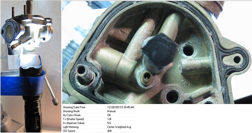

b]Pilot Jet - Orifice Open Verification by Light[/b]
One method mentioned on this board for verifying the pilot is at least 'not plugged' is by light.
Note: Start with an expectation the test requires a bright light and that the pinhole of light remains dim.
Here's a pic of the carb showing a clear Main Jet and no visible light through the pilot jet - even though the pilot jet is clean/clear.
The reason the pilot jet is so dim relative to the Main Jet, is the light path is indirect.
The carb body idle mixture passage is offset from the pilot jet orifice
Light from the carb slide side, must bounce off the pilot jet then bounce off the carb body.
Photo setup to verify idle jet
Indoors, I use a bright flashlight, to view the pilot passage, and it's still relatively dim.
Using a camera can help make the light visible, note the camera setting of 1/6s, ISO400.

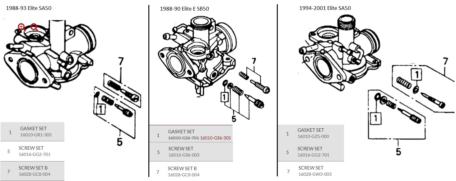

Carb models with O-Rings or washers on the adjustment screws
In creating the table in the last post, it was noticed only 3 models had o-rings on the mixture screw
Note the p/n between Item 5 'mixture screw' is same between 88-93 SA50 vs 94-01 SA50. The parts fiche may have omitted the washer.
The 94-01 SA50 added an o-ring to the idle speed screw.
