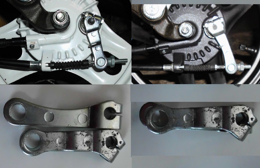

added metropolitan rims
will need to re gps
but I think the added rotational mass slowed up the top end of the moped
metropolitan brake arm is longer and fits the elite hub
made the brake lever move more to apply brakes
but the force needed to apply the brakes is a little less
and the cable pull is straighter with the metropolitan brake arm ?
see the white rim the cable goes upward

I have a met hub; the kind with two brake cables. Im gonna pull off one of those levers and give it a shot. That straighter cable probably returns to home position better than its shorter counterpart.
Re: the one owner 2001 indy elite build
Posted: Tue Jul 21, 2015 11:17 am
by cruzingratiot
graphite9 wrote:I have longer aftermarket billet brake arms, just haven't tried them yet. Let me know how they work. I think you'll have more throw/travel required but greater leverage.
less effort more travel I like it for stock brakes

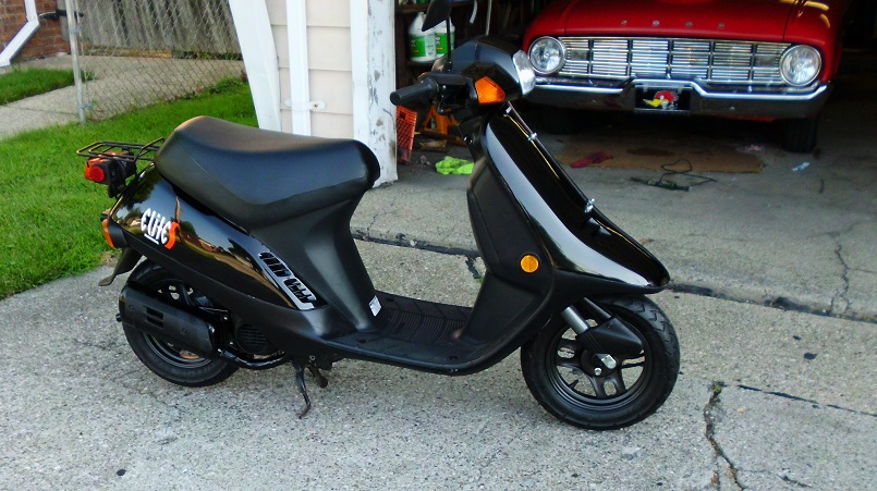

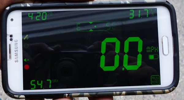

went for a 30+ mile ride with some friends
I wasn't riding it
we were riding the POP bike POP build link
my Mystic Purple elite Mystic Purple elite build link
and this 2001 elite
but when we got back he showed me his gps and it hit 54.7
it was last ride with me owning all 3 of the elites in the picture
was made a offer on the POP bike and sold it
specs
stock motor derestricted
premium gas amsoil dominator injector oil
polini variator 6,9 weights
stock contra
9to1 gears
metropolitan tires / rims
1534 miles on bike
