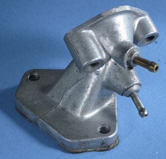

This is the carb body. I haven't had as much time as I'd like to get moving on this. I appreciate all contributing to the solution.
