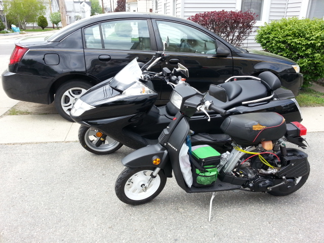

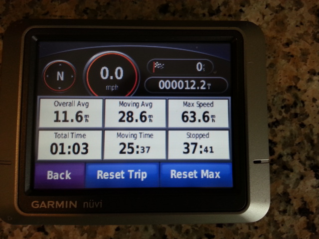

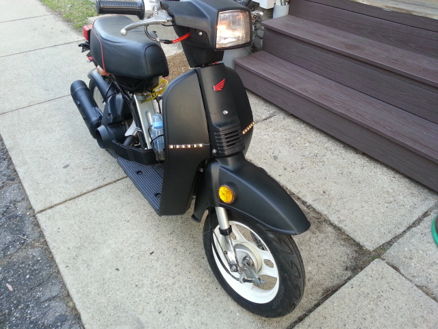

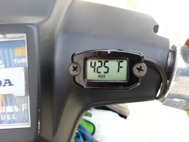

Hi forum.
It's official 63.6 MPH on the stock pipe, & carb. gas saving spreedio.
the motor did get a little hot, temp at 425 max. I will have to fix that.
the old belt was slipping, I cleaned it with some brake clean for now.
I will be putting in a new belt and doing another test soon.
All the specs stayed the same just a clean belt, and added some cooling holes.

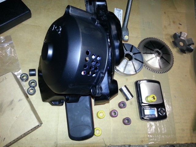

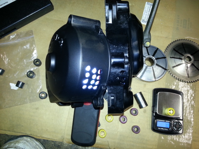

Hi forum.
I added some vent holes for cooling.

Wheelman-111 wrote:Greetings:
The belt drive cover was designed for safety and a Sanitary look. Also to keep kids' fingers from being severed. While the cover works OK with a 4-horse powertrain pushing it a little above 35, I do believe the cover is best left off for speeds you're now reaching. That's very impressive, by the way. Betting you're really glad you have that Met brake panel now!
Thanks wheelman.
What a difference a clean belt and 7&6 Grammies make. (I had 8&9grams before)
I will soon put a new belt, and bring down the carb C clip.
We have yet to see a really sunny day. I will have to keep the cover on because of rain. (will make the belt slip).
the met hub works great. I will never go back to stock spree brakes. ( They just don't stop at that speed.)
*the spreedio
Af16 swap
Rumina stock crank
8.4
TT temp gauge (425 max)
Pre mix oil 4 to1 (oil pump plug)
Stock exhaust pipe. (drill out washer)
Stock carb (91 jet)
stock mani, reeds, air filter
old stock belt (cleaned)
$27 china feebay variator
rollers (7gm-6gm)
stock tire 3.00-10
stock rear springs.
met brakes
LMH

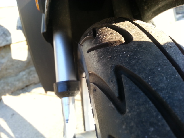

I think the max speed on the spree forks is 65mph. and They are too small for the pot holes.
I will have to swap over to the bigger metro fork. as I will try to reach speeds of 70+mph. :thumbwink:

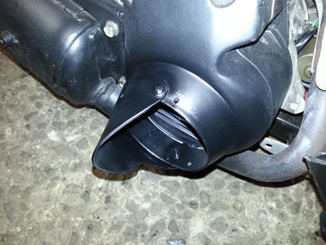

I can only go about 20 miles on a 2.5L gas tank @ WOT.
I lowered the C clip on the carb.
Added a scoop for more cooling. ( got this tip from wheelman).
I'm going to put a bigger tire to try and reach speeds of 70+mph. :nervous:
