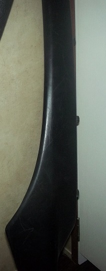

dem0nk1d wrote: So the question is the gray plastic panels, did they come gray from the factory or black?
Experimented with propane torch on the side skirts.. Quick passes... Notice the difference...
they come black
this is about as close to factory.
panels pics.jpg (93.31 KiB) Viewed 14958 times
dem0nk1d wrote: used tha snake oil stuff back to black doesn't do any good. will be preping panels and using bumper paint
what about the melting the panels back to black heat torch method idea? what happenned to that?
