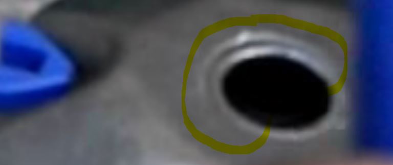

what is strange to me then is that these grooves appear within 15 miles. ive wrote this. what is strange about it, is i had, as in threw out, a bag of slide guides.
Ok, now why would these plastic guides take a ditch being dug in them? maybe the picture isnt clear enough, but if you see the rest of that blue and see how fine it is, then that ditch being dug. that happenned in 15 miles.
and you can see that black slide, its stock oem chinese scooter stuff. and it reminds me of exactly my guides with 1000's of miles on them. you can see no weird marks on them
why you don't get that i dont get. it wouldnt matter if the pictures where clear. LOOk at the black one and LOOK at the blue one. the black one shows no signs, OF DITCHES. the blue one DOES.
the difference between these two.
wearing: blue has about 15 miles on it, that ditch is about a mm or so deep.
the black one. has 1000's of miles on it. show no signs of stress.

bajack - your pic of the guides appears to show the mating face of the ramp plate is damaged.
-- Below is not proven from hard *scooter* failures. I'd dig into this given the initial ramp plate damage. Might be un-related <shrug> yet IMHO worth knowing the cause.
1) Check the pulley width (with no belt present) variation over a rev. If there is a ramp plate wobble, then the belt acting as a wedge may force movement between the ramp plate/sliders for each rev of the engine.
2) Get back to a golden ramp plate
3) Determine *what* damaged your ramp plate.
At 8-10k rpm, you are within 1/2 of the low end frequency plastic ultrasonic welders use to melt/bond plastic, so short stoke, rapid repetitions *might* cause heating to facilitate guide failures.

the drive boss is new. 3000 miles its got on it. i bought it. new in package. ive got like 5 ramp plates. this damage seen on the back, i noticed that. i dont understand the pulley width? its new. that would be pressure damage. seems itd be too long, and no its new. how did it grow?
im not understanding what your saying could of caused the damage.
that ramp plate, the one in that picture, looks the worst. it was rode the most. its the one ive used the most. i noticed on teh back of most of my ramp plates it seems like this, but here, lately it seems worse. ever since..... this new belt.
your 1) seems to be fixed, if i do a 2). so i done a 2). i changed that ramp plate out. with another one sitting around here. and i used the stock ramp plate which wasnt used much by me. it did seem it was getting damaged more. this is damage from that, i think.
doesnt seem anything else is making the daamge and you didnt say what it was, and i cant find nothing to look at.
from what i think, it's this that caused it. this, as in. this same problem as of now. that im trying to go back to the stock parts to check on. ive re stockified everything so far, and ran into this belt. it matches that other suggested belt tahts why i posted it there. why i posted this, there. in suggested applications. so i was wondering why i was having the problem.
but im going to get the stock belt, some of the ramp plates i havent used with this yet. and usually all my ramp plates, get this. its from sitting pressed against the crankshaft arm. the nut gets torqued down, 45ft /lbs or something. i had started making it also a thing to use the ratchet, and a glove and tighten it down until it just needed torqued, then using an impact wrench, hitting it around 8 times. or so.
just to torque it on. then when id use this same impact wrench, the 160ft/lbs harbor freight model, with my car on and its the cigarette lighter one, id wack it on with 6-8 hits car running. and when i went to take it off, the car wasnt running, and it could take, 2-6 hits to knock it off. ive ran bigger same type of impact wrenches that would take 10 good hits to knock it off. and never seen, this much damage, to the ramp plate on the back, and never, had any cvt problems. unless from being old. such as the belt breaking. which hasnt happenned, ive just swapped belts. this is the 4th belt ive ever put on. and the only one ever had a problem with anything after putting it on. anything that doesnt let me just ride it down the road.
thats the most damage i have seen a ramp plate too. i switched my ramp plate after that and same problem, id get. the plastic slide guides would get dug into.
i dont think the ramp plates are destroyed. just ate into some. yea and i didnt like it either, cause theyre perfectly good.
so when the belt comes in, ill put it on, with fresh chinese guide slides, and a ramp plate thats came off a working bike. that hasnt been in this. with fresh lubed driven pulley. I'll see. and see if itll work.

Mouse's amazing eye. If the ramp plate wobbles, the in-and-out movement chews up the plastic inserts. Also Forum be advised blue Polini inserts fit poorly in any other brand of ramp plate, and vise-versa.

there is no wobbling. i pretty much went over my cvt and checked for that.
did notice damage on the crank arm but its a little ahead of the ramp plates spot where it sits on teh crankshaft. but not where that damage is coming from.

what exactly about them is accounting for these damages then? cause i cant figure out what to look at anyway.graphite9 wrote:Any way you slice it, it's not your belt. It's not your clutch, and it's not your variator. You have the following components that can contribute to this.
Crank
Boss
Variator
Drive face.
It's whatever you haven't replaced. It's not the belt. I've never seen an off-true variator. It's your drive face, or your boss. Or, you could possibly have uneven roller weights.
