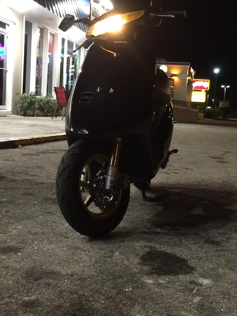

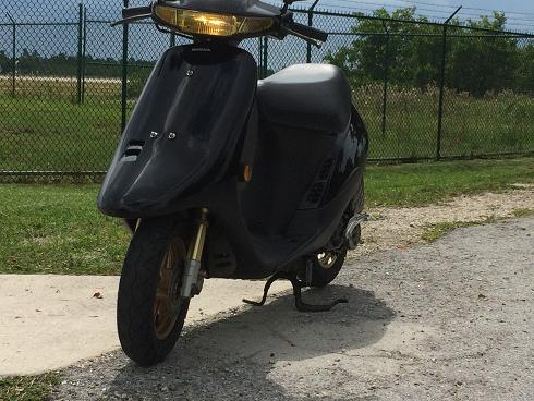

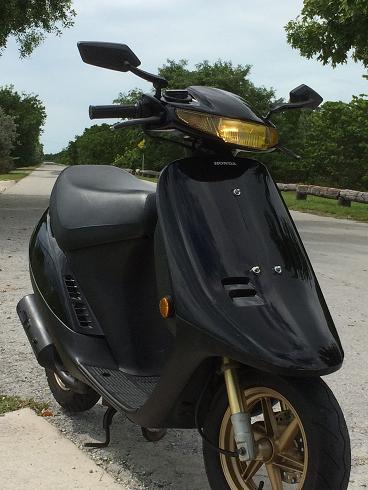

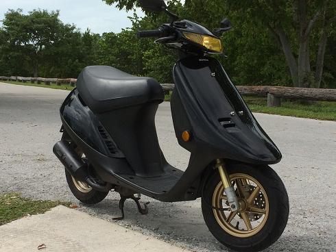

Updated::::: We were able to shorten the front legs. This looks so much better now!

Downsouthdio
Posts: 835
Location: Key west
Re: Dio disc brake front on Elite frame
Post by Downsouthdio »
One of my favorite bikes!! Beautiful ,awesome job b!

Ahh dang looks much better, great job!

Kool mirrors too.....what brand?
'92 Super Dio ZX - AF18 Corsa
bonesv
Posts: 1616
Post by bonesv »
S4Patrick wrote:NICE WORK!
Thanks Patrick! Those mirrors came from a local scooter shop. There was no packaging and he said he got them very cheap on ebay. Must be from china?lol.....They vibrate a lot when under way so I would recommend staying away from them. Constantly loosening, shaking, and small window of vision makes me want to toss them away. But, yes, they look Kool!

Well, it has been a while since this thread had an update so here is what's been done.......
I found a 200mm floating rotor and adapter kit to fit on my oem honda dio forks/wheel (10mm axle) and uses the same oem caliper. I did have to do some slight grinding for clearance here and there but it basically bolts up with no problems. Surprisingly, it was made in China, but I had also purchased another similar kit made in Taiwan and it has issues and does not fit correctly.
So far the product I have installed performs better than the oem honda dio 160mm rotor set up. IMO It now has better stopping power and there are no issues if it is correctly installed. If anyone wants to buy one of these 200mm kits for dio disc, please pm me for details. Bones

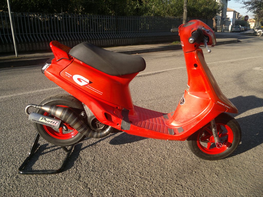

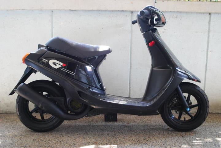

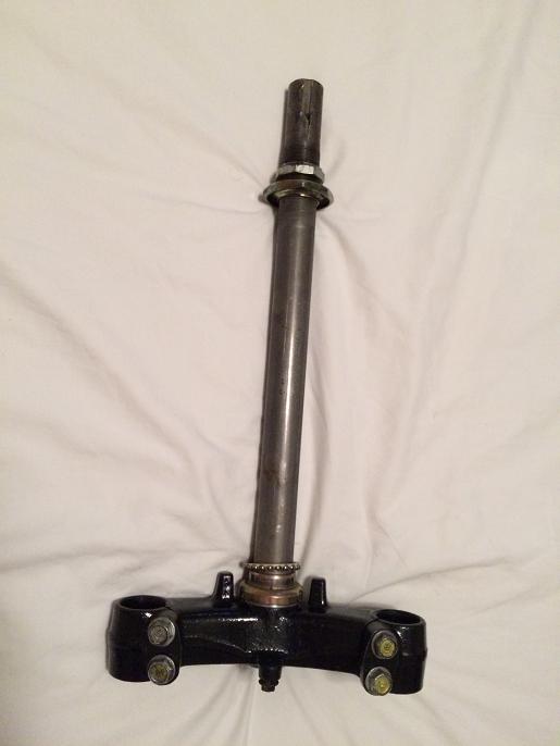

Yes, I have seen this done. It is not so for the sa50 elite. The sa50 elite must be modified to accept these stems. In reference, the G stem is same size as a metropolitan stem, and a dio zx stem, in terms of stem length and width of fork spacing but I believe you could use wheels up to 3" wide with any of these stems. I have also seen the G stem used without mods on an se50. Here is a pic of a "G" stem from a Dio G-Dash. And some pics of a Dio G Dash
