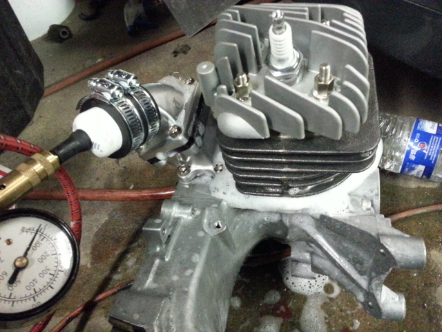

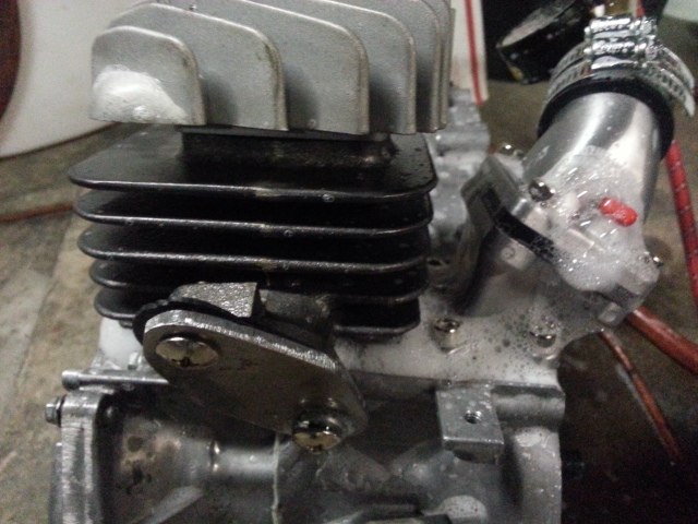

hi Johnny. look at my engine, it leaks everywhere.base gasket, carb gasket, intake gasket.
try the jet first like graphite said. I would do a pressure test for leaks. gl.

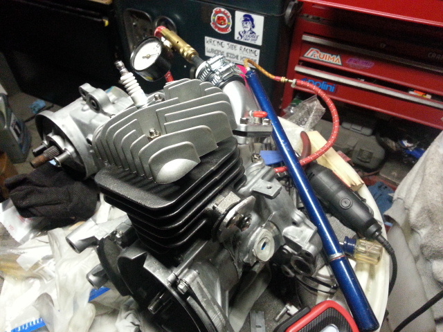

How did you go about doing that? Did you just block off the exhaust, and clamp in a cap with air fitting into the carb boot? How much pressure are you putting to it?

Hi Johnny. you block off the exhaust with an old tube. you get an air pump with a gauge on it, a valve stem from a tire, a three quarter inch PVC end cap from Home Depot. drill a hole in the center, pull the valve stem through, attach your pump with a gauge. pump up to 6 pounds! if you go over you can blow out your seals.
spray a little dawn soapy water. check for leaks. good luck.
scroll down on this tread you can see a better picture.
http://www.hondaspree.net/phpBB3/viewto ... er#p248933
Hay, by posting this reply I noticed the lower right head bolt was not in all the way.
