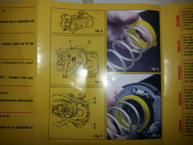

According to fancy drawing you get it goes on the clutch side. And yes this is one part I'm gonna keep a fresh one in there. Gonna pull mine and see how it's doing. I've got maybe 300+ miles on it.

Re: center spring saver
From the horses mouth
- 20150518_121847.jpg (167.36 KiB) Viewed 7879 times

That's a torsion controller, similar to a spring saver. The radial ball bearing supports are the ones that go under. Torsion controls and spring savers go on top. Spring savers don't do much.

And here folks is commonly referred to as a a a a spring saver a say you. You put this darlin on top o the spring but under the clutching area.
