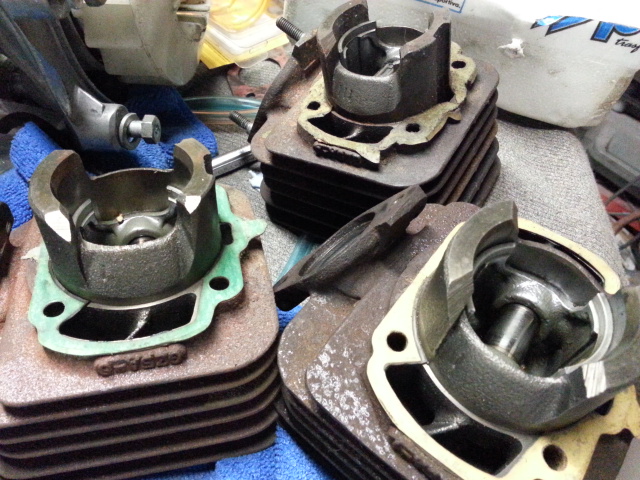

just to check, I took a photo of some stock cylinder heads for comparison.

So it looks like they have all been beveled at the skirt overhangs?

Yes, it looks like it.Wheelman-111 wrote:Greetings:
