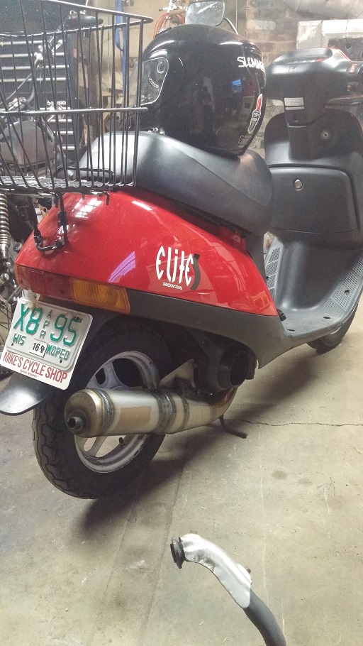

Got bored today so installed this slightly used PG Long I purchased off the forum. I can't believe the improvement over stock exhaust. When cruising at 40 and I pin the throttle, it buries the speedo within seconds!
After hearing all the reviews, it isn't as noisy as I expected.
Now just gotta paint it black... gotta keep that stock look!
