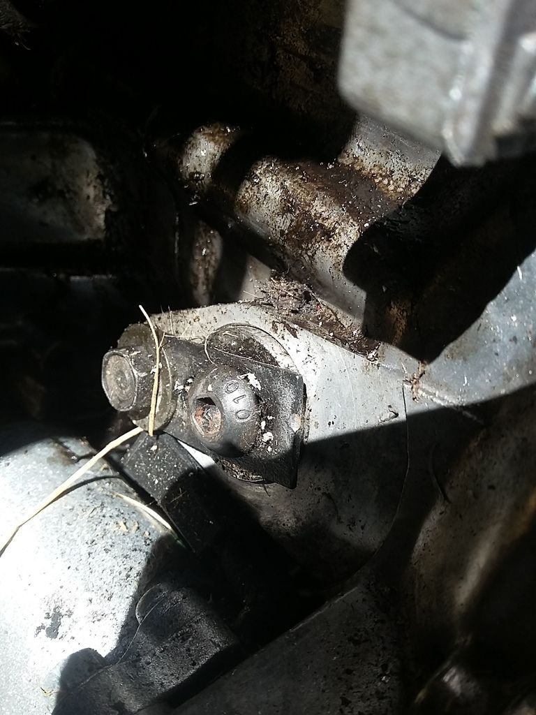

Here's what mine looks like now. No big washer available so I used this small bracket. Big o ring off, only using o ring from oem pump.
Here's what it looked like w the o ring it came w. Btw, this is an af05 from an aero not an af16 or af18, I don't know how those would fit but I assume it would be the same pump and plug footprint.

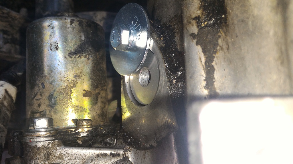

Man it's amazing what a little oil will do. Rubbed down the oil plug real good and it popped right in, didn't even need to hammer it. Picked up a 6mm bolt, lock washer and the big washer 1 1/4" i believe it was for $1 at home depot.

Bottom is correct but screw it in till you run outta threads.
Re: Problem installing BBK
Ya, it looks a little low to me... are you using an o-ring ?

Yes using the o ring it came with. Here's a closer pic. Didn't think it was a huge deal sitting just under the rim but if it is I can go back to home depot and grab another bolt and washer for a buck.
I would try slipping off the o ring it came w and using the one on your oil pump, see if it fits flusher. You might have a leak there. It doesn't look like it's sitting right to me.

Thanks benji with oil pump ring it fits like a glove perfectly flush.
