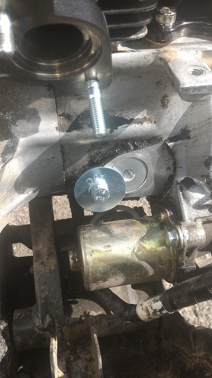

https://youtu.be/xvMh3US18Io Here's a clip of my first start up. Haven't tried tuning at all. Has a 110 main and 40 slow jet to start off, also forgot to set the carb screws so not sure how far off they are. The rpms are little high, i believe 1800 is idle? running in low 2ks. Ran it for about 5mins or so to warm it up little, tomorrow is tune day!
Man it's amazing what a little oil will do. Rubbed down the oil plug real good and it popped right in, didn't even need to hammer it. Picked up a 6mm bolt, lock washer and the big washer 1 1/4" i believe it was for $1 at home depot.

Re: Problem installing BBK
Posted: Sun Jul 03, 2016 11:05 pm
by Meatball
Bottom is correct but screw it in till you run outta threads.
Posted: Mon Jul 04, 2016 1:26 pm
by benji
Ya, it looks a little low to me... are you using an o-ring ?
Posted: Mon Jul 04, 2016 3:10 pm
by FunkeyMonkey
Yes using the o ring it came with. Here's a closer pic. Didn't think it was a huge deal sitting just under the rim but if it is I can go back to home depot and grab another bolt and washer for a buck.
Posted: Mon Jul 04, 2016 7:56 pm
by benji
I would try slipping off the o ring it came w and using the one on your oil pump, see if it fits flusher. You might have a leak there. It doesn't look like it's sitting right to me.
Posted: Mon Jul 11, 2016 4:10 pm
by FunkeyMonkey
Thanks benji with oil pump ring it fits like a glove perfectly flush.
