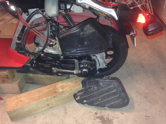

As many of you know, Ive swapped an 87' Elite motor into my Spree. When I got the donor motor I opened the airbox and the filter was dusted. I ordered up a new one from Noiseguy (perfect fit btw) and oiled/installed it. After doing some tweaking and tuning, its time to put on the plastics and let er rip. To my dismay I find out the plastics WONT FIT ON! The muffler nearly touches the plastic on one side and makes contact when the spring compresses when I sit on it. The bigger problem is that the other side wont even go on AT ALL because the airbox is so fat!
I know I could just cut the plastic on the muffler side for clearance but Im not crazy about a goofy looking cutout. I also know I could ditch the stock airbox and go with a pod filter but then I'll have airflow/tuning nightmares.
I have another airbox from a different AF05 motor but it doesn't fit on AT ALL because it hits the shock mount on the motor and the angle of the tube connecting to the carb is all wrong. SEE PIC of both airboxes I have. The one installed came with the donor Elite. The one on the ground came with a parts motor I bought for the un-restricted parts.
What can I do to use the Spree plastics without butchering them and making it look like a Franken-bike?
- air filter.JPG (122.05 KiB) Viewed 7890 times
