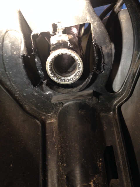

I had to hogg out the inner fender plastic to make room for those pesky pegs again. Made quick work of it with a soldering gun. Its not pretty but it was getting cold and I was running out of f#cks to give at this point.
Also, that lower bearing cup you see is from the Met. I decided to swap it since I wanted to get away from those stupid loose bearing balls Honda puts in. That's the met bearing in the pic too....was a neat idea but it ended up screwing me later because it makes the whole tree sit lower about 1/4". When putting the bars on, theres a notch in the stem that the head bolt goes into when the bars are set at the correct height. I had to do some grinding on that notch to get the bolt through.

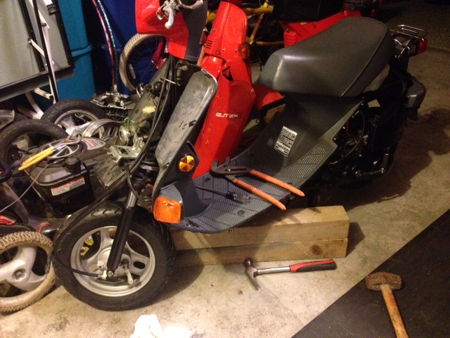

Legs on, bars on...
