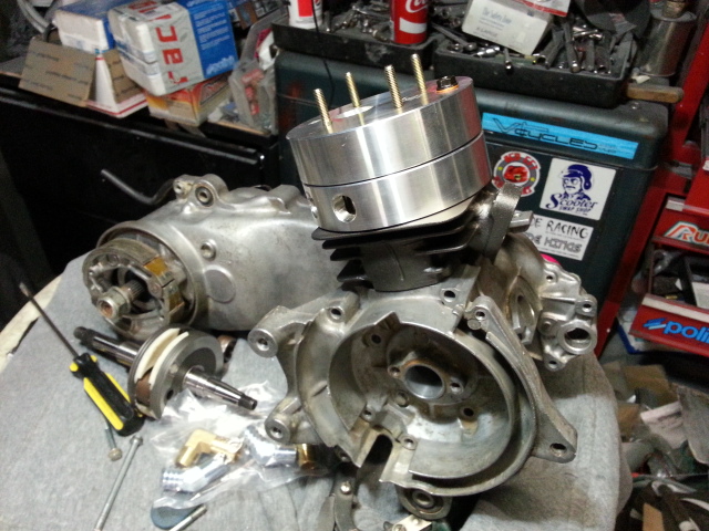

Change in plan forum. going with the 54mm liquid cool Big Bore Kit.
:coolcruise:

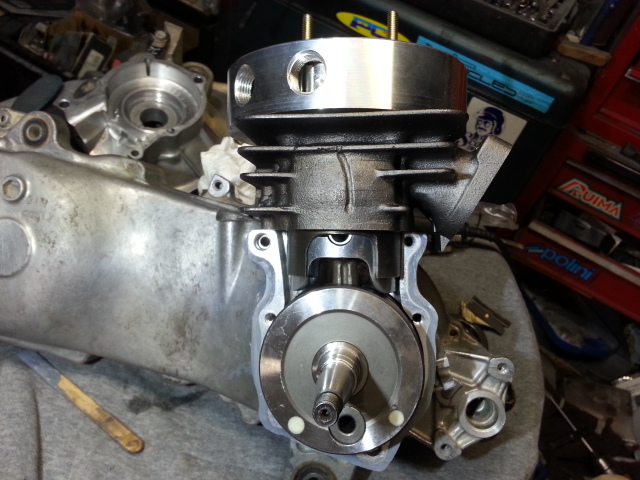

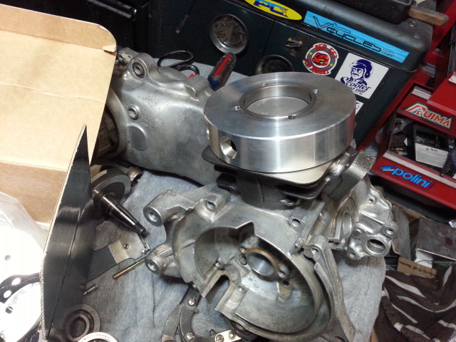

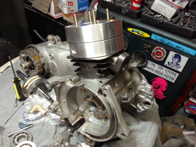

Forum this is going to be a 120 CC liquid cooled motor. :geekdance:
Picked up the water cool cylinder from scooterswapshop they have them :thumbwink:

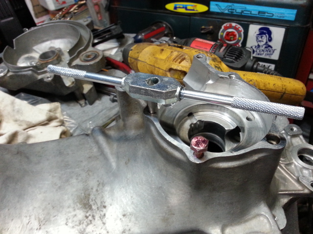

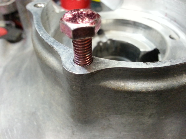

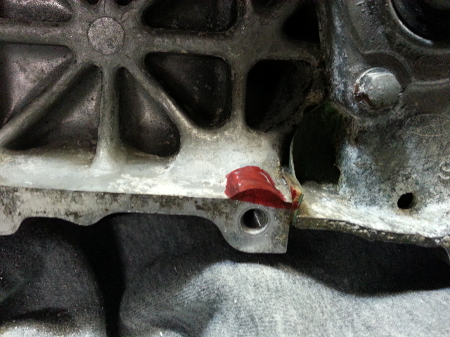

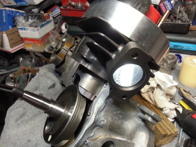

Forum, You can drill, and put a bolt right through left side holes. :thumbwink:
I drilled and tapped the hole. I used a smaller drill bit so not to cut the threads. :geekdance:
Forum, change in plan. I just drill straight through makes life easier.

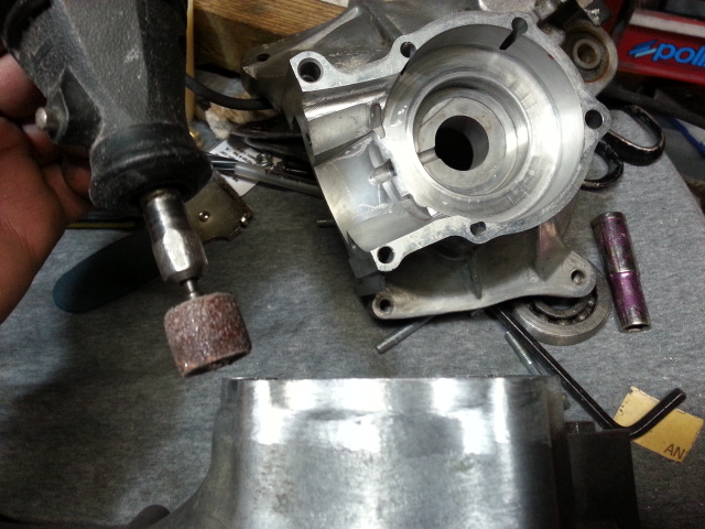

Post by ped »

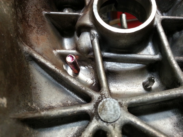

I used this Dremel tip to flatten the surface so I can add a lock nut.
ped
Posts: 1598
Location: northeast usa
Re: 54mm build/ nuts packed in box
Post by ped »
:coolcruise: I'm not sure if you can add a nut to the opposite side? I don't think so. the third hole is fine. I'm not going to go through the case. :thumbwink:
The tap is M6-1.0 .

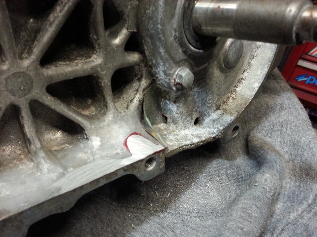

Post by ped »
I'm going to make the clearances for the ZX Drive Variator. I'm also going to smooth the small bump in the back. rubs on the belt. :thumbwink:

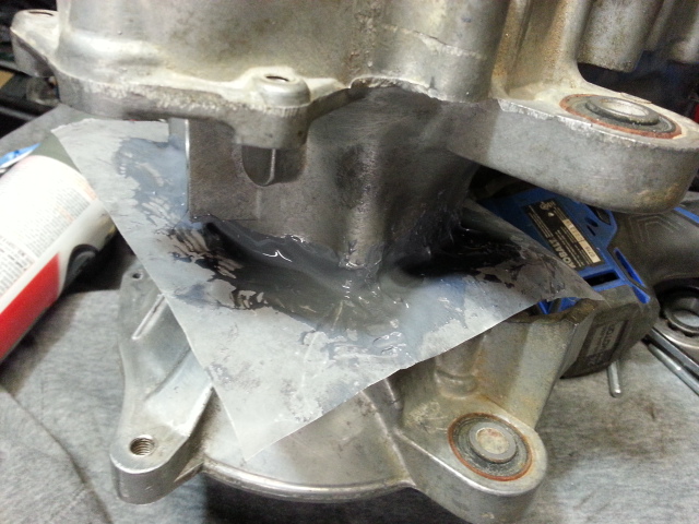

Post by ped »
I'm going to use J-B Weld on the thin case. To add thickness to the case, For sealing purposes. :nerd:
J-B Weld, and Wax paper.

Post by ped »
I've used J-B Weld for sealing on one of my other Motors. been on there 3 years no problem. :thumbwink:
Before I put it together . It takes 24 hours for this extra meat to dry. :nerd:

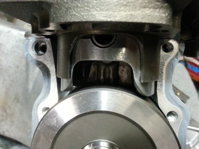

hi forum.
I've cut almost all internal walls inside the motor. :smile: more photos.
Forum, hopefully someone can make a bigger after-market case? there is no room in stock cases. :coolcruise:
