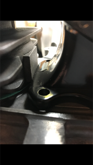

During jug install, base gasket thickness was determined and squish was checked after torquing down the matching 50mm head. After the motor is running, I may have to change head gasket thickness to obtain the ideal compression range. I realize this would change the squish but too high/low compression would be of higher importance. If squish is way off, I may need to mill the head or add gaskets to get it sorted.

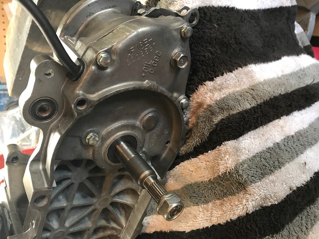

Rear brake assembly, starter motor and Stator/flywheel installed. Crank oil seals greased and squeezed in to the proper depth. The 8.4:1 gears Ive chosen for this build will be pressed and installed in the next few days. Once the trans is sealed and filled I will move onto the vari/belt/clutch.

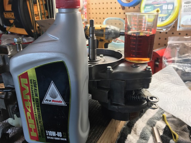

Gears pressed...installed...filled with precisely 3oz of special juice.

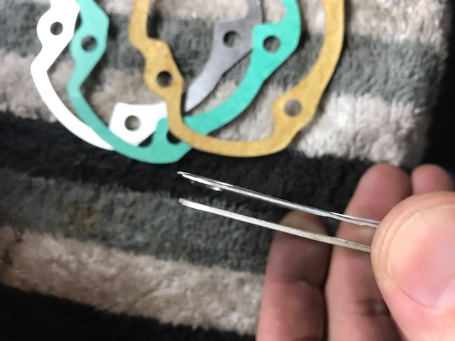

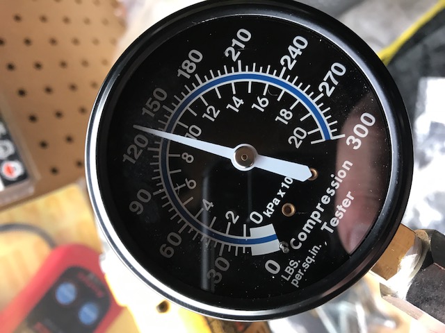

Bench testing compression. I have a few head gaskets of different thicknesses. I initially had installed the thinnest one of 0.38mm. Check pic for results..

Compression of nearly 140psi is unacceptable...need a thicker head gasket...I switched to the next thickest I had which is 0.5mm...results below

The head gasket of 0.5mm dropped compression from almost 140psi down to 130psi....getting better but still not there. Putting in the fattest one I have which is a full 1mm thick.

BOOOOOOM....MONEY! 120psi on the button! :2thumbs:....almost ready to fly this bird!

You can run compression at 140PSI, but pretty much only with Avgas or 110 Octane racing fuel... at least I did. See F7
